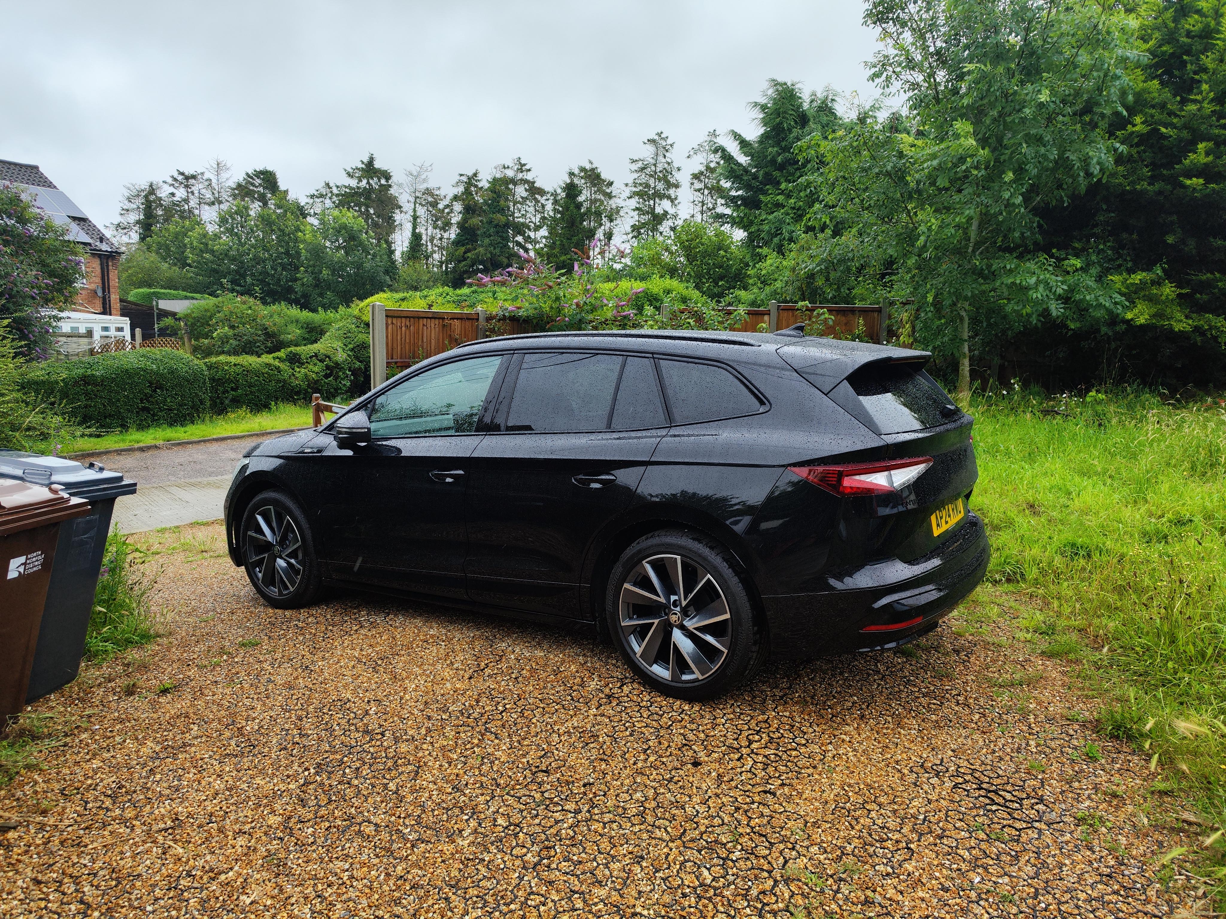

                    Ordered the 85X Sportline Coupe today in black. Will be approx six months on the waiting list but they will let me know if they get any cancelled orders in the meantime. Still have our 71 plate IV60 until the new one arrives and then I’ll put the IV60 up for sale.
                    Nice the black is stunning I got the estate and I changed the bonnet badge to black too looks amazing

                      BlindBat
                        Our first choice is black and closely followed by race blue. I’ve told them I’ll accept a cancelled order of either.
                        The glass roof swung it for us on the Coupe. We’ve had the estate for three years and felt the Coupe would be a nice change. Plus the extra range and power over our IV60!
