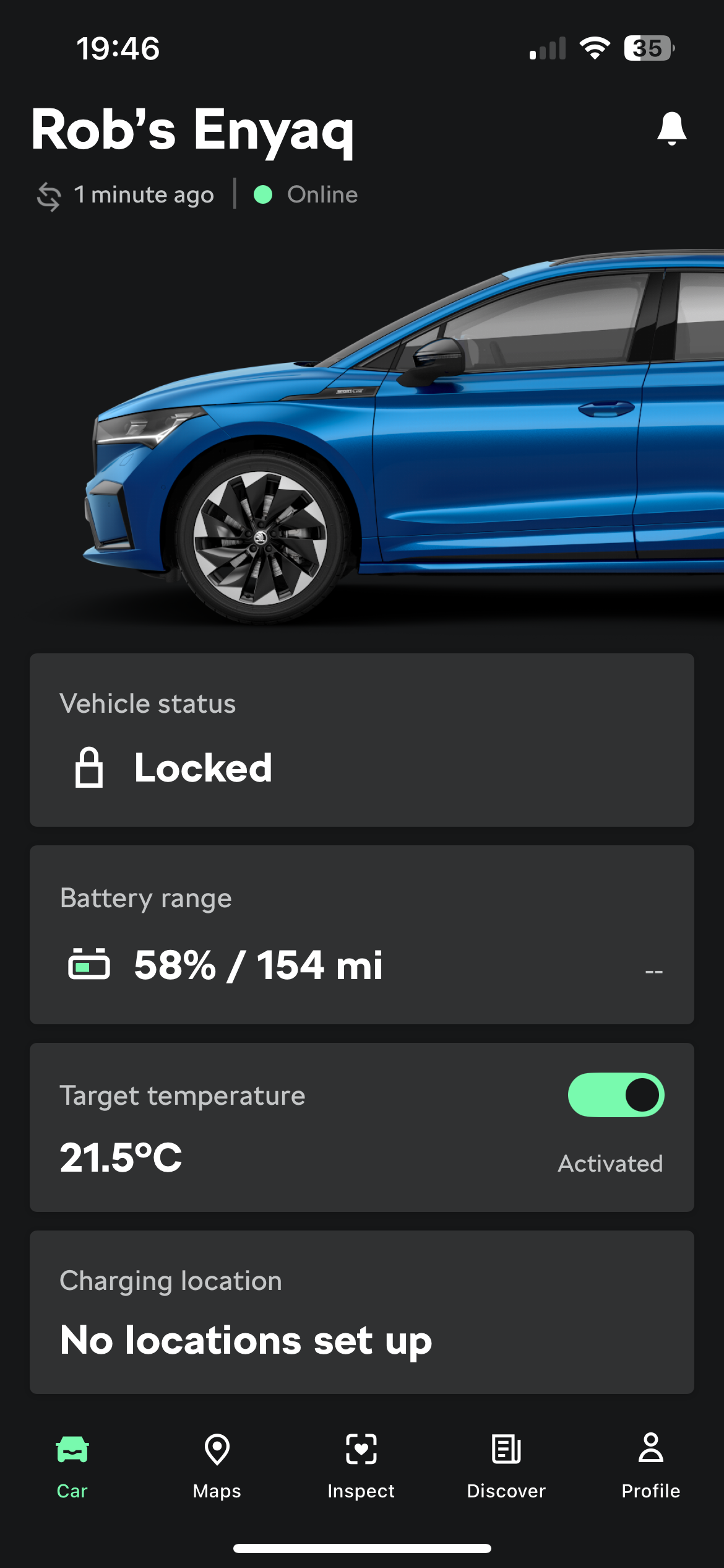

                                Remote heated wheel and seat activation.
                                I might be teaching grandma to suck eggs here but I just noticed in the My Skoda app if you open the target temp section then tap the 3 dots top right you can set it to put the heated steering wheel and seats on too so as well as warm air you can have toasty hands and buns too.

                                  Remote heated wheel and seat activation. I might be teaching grandma to suck eggs here but I just noticed in the My Skoda app if you open the target temp section then tap the 3 dots top right you can set it to put the heated steering wheel and seats on too so as well as warm air you can have toasty hands and buns too.
                                  I used the app interior heating thingy today for 10 mins as i still had ice on the screen late afternoon very handy feature to have in a car……and i wondered what those three dots were for so next time i do the pre heat thingy i will engage the seats and steering wheel pre heating too.
                                  Good info @Rich44

                                                  That’s really odd about the lack of preheating because that’s controlled by the car not the app if you set a deperature time.
                                                  If you open the temperature target in the app and tap the 3 dots is the seat heating enabled there?

                                                    That’s really odd about the lack of preheating because that’s controlled by the car not the app if you set a deperature time. If you open the temperature target in the app and tap the 3 dots is the seat heating enabled there?
                                                    I’ve just checked the app and preheat is now available again. It’s set for heated seats during pre heat.
                                                    the car is plugged in awaiting octopus to start its charge tonight so not sure if that has helped.
