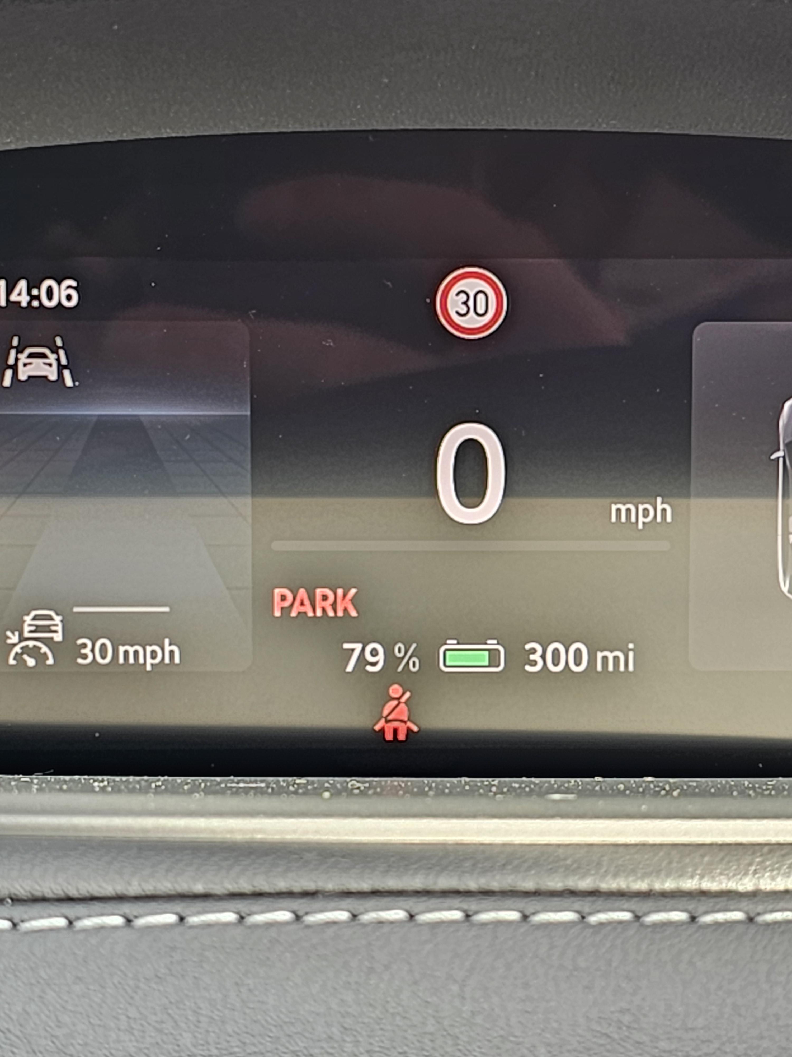

        Petrol-Head
          That’s the range
          And it’s consistant and I would say correct .
          But it can’t be
          Longest distsnce between charges has beenen 280 miles and it had 11% left and its only changed to 80%
          Not charged it to 100% other than the day I collected it.
          It’s more economical than both my teslas ,just not as fast
          Then my car got to the UK it was in tge docks for 1 day then at the dealers.
          Just letting you guys know as I wasn’t happy with what I could find about range or economy
          Had 5.2mi/kw when I tried hard lol

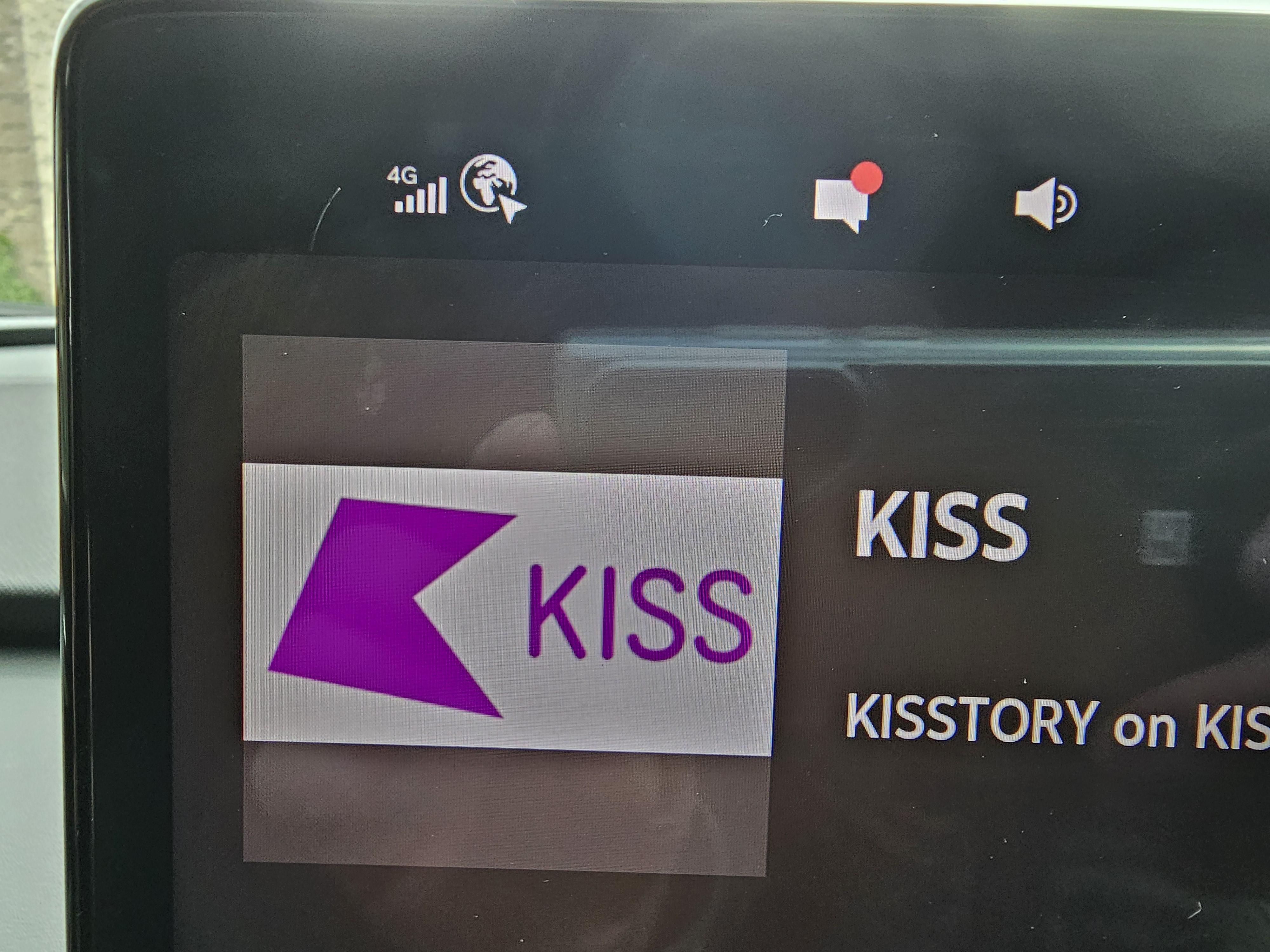

                      Petrol-Head
                        #282199
                        Petrol-Head
                          The 4g was missing in the top left corner, and they hadn’t come across this before.
                          20 mins and and a setting altered by the workshop
                          Bosh done
                          #282200
                          bolly1143
                            The 4g was missing in the top left corner, and they hadn’t come across this before. 20 mins and and a setting altered by the workshop Bosh done
                            Fairly common fault, if happens in future simply remove fuse 19 (online services) for few mins
                            and should reset connectivity.
                            Saves a trip to dealer.
                            #282233
                            Petrol-Head
                              The guy from the workshop said it was in a build or factory setting, and needed to basically be told it was finished been built.
                              He did allsorts to it before plugging it in to be fair.
                              He had not seen it before .
                              I only know what i am told.
                              #282234
                              bolly1143
                                The guy from the workshop said it was in a build or factory setting, and needed to basically be told it was finished been built. He did allsorts to it before plugging it in to be fair. He had not seen it before . I only know what i am told.
                                Yours may have been something more serious, mine was the same .
                                The car tries to obtain signal every few hours initially then reverts to twice a day thereafter and you usually get “E” symbol.
                                I had tech on phone for hours and reactivated services with them and they then booked in for some sort of GSM module repair, tried removing fuse rather than go workshop and then bloody worked.
                                Seems to do the job for 9-10 people.
                                Happy motoring 🙂

                                            That 4g thing was resolved the day I collected the car.
                                            Never had a issue since ,4g  is constant.
