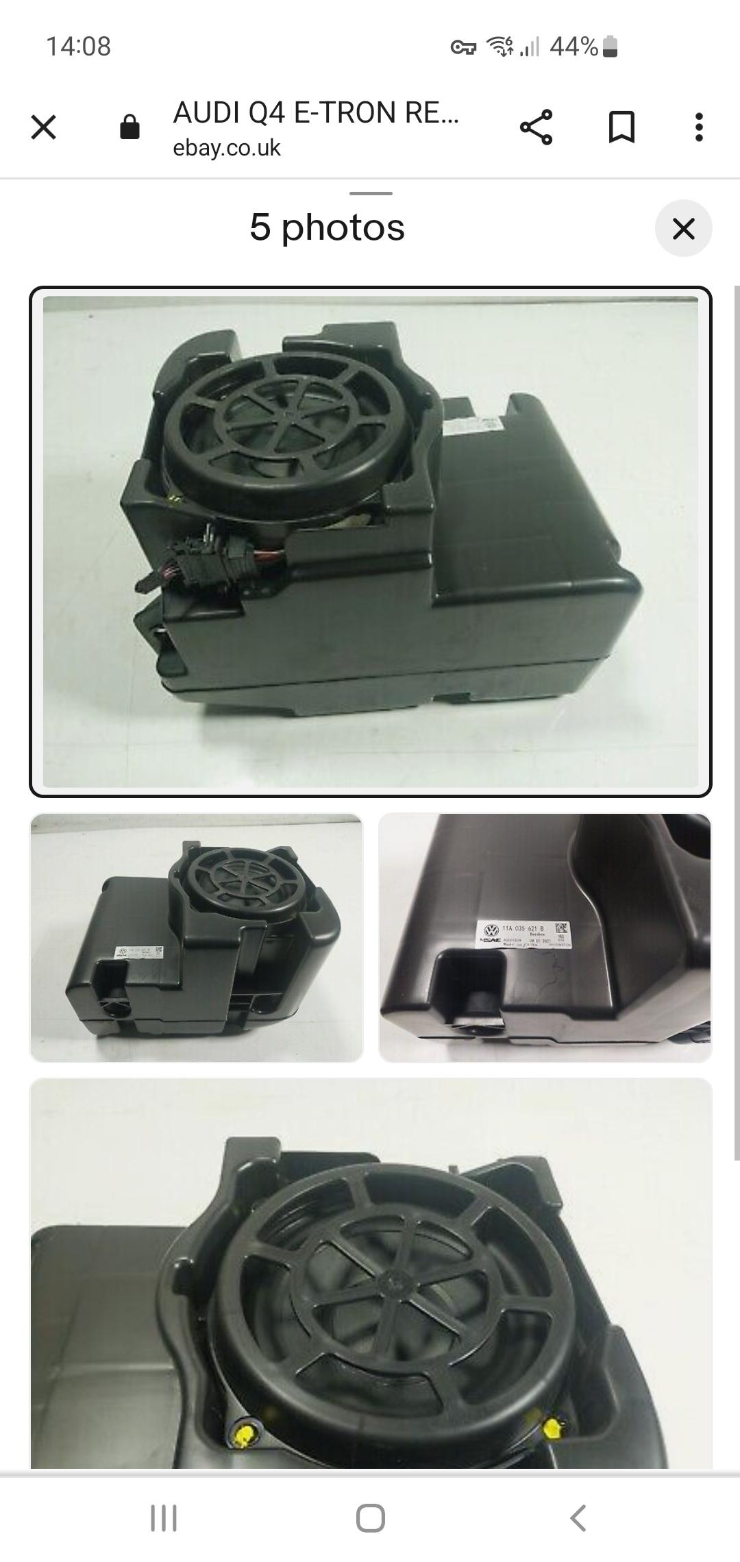

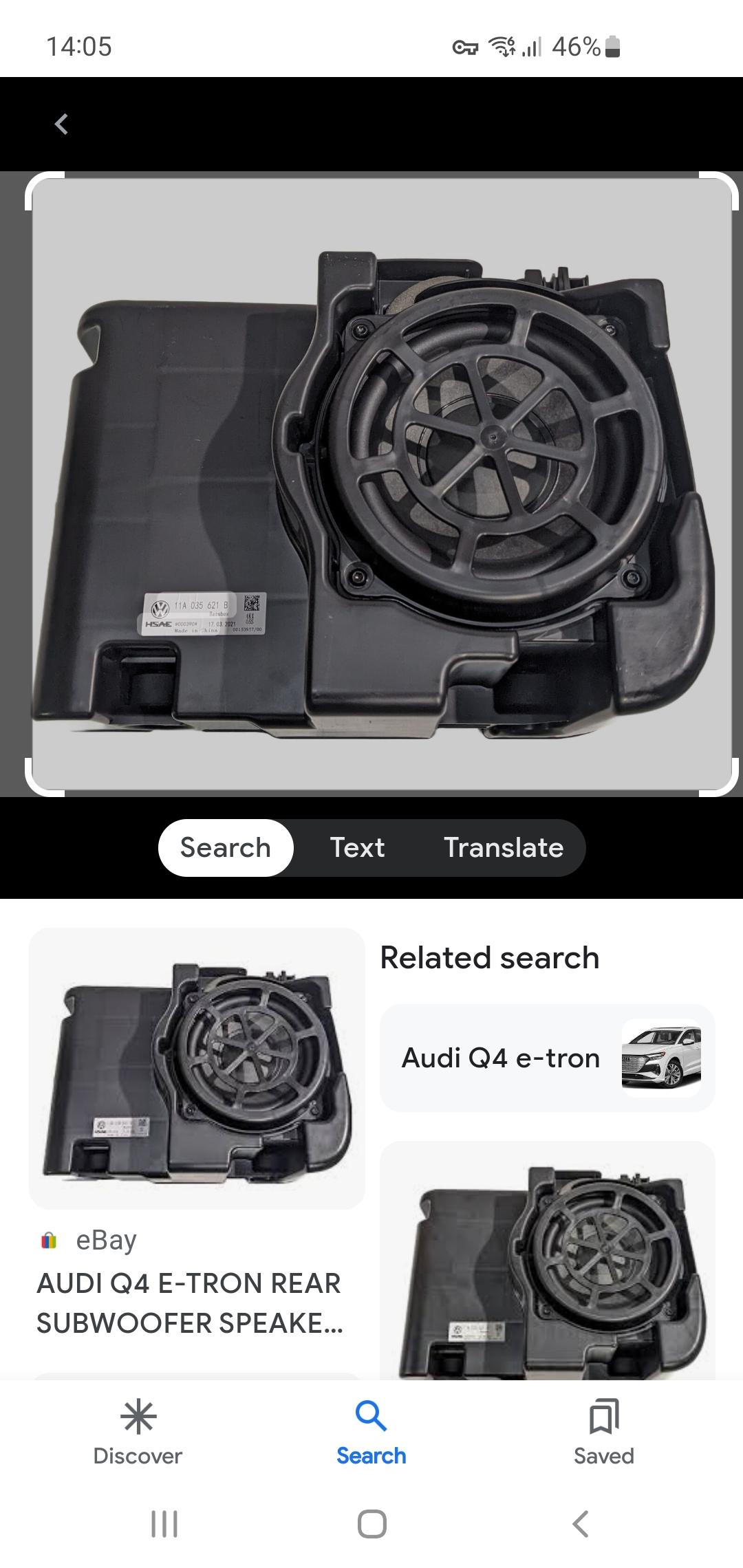

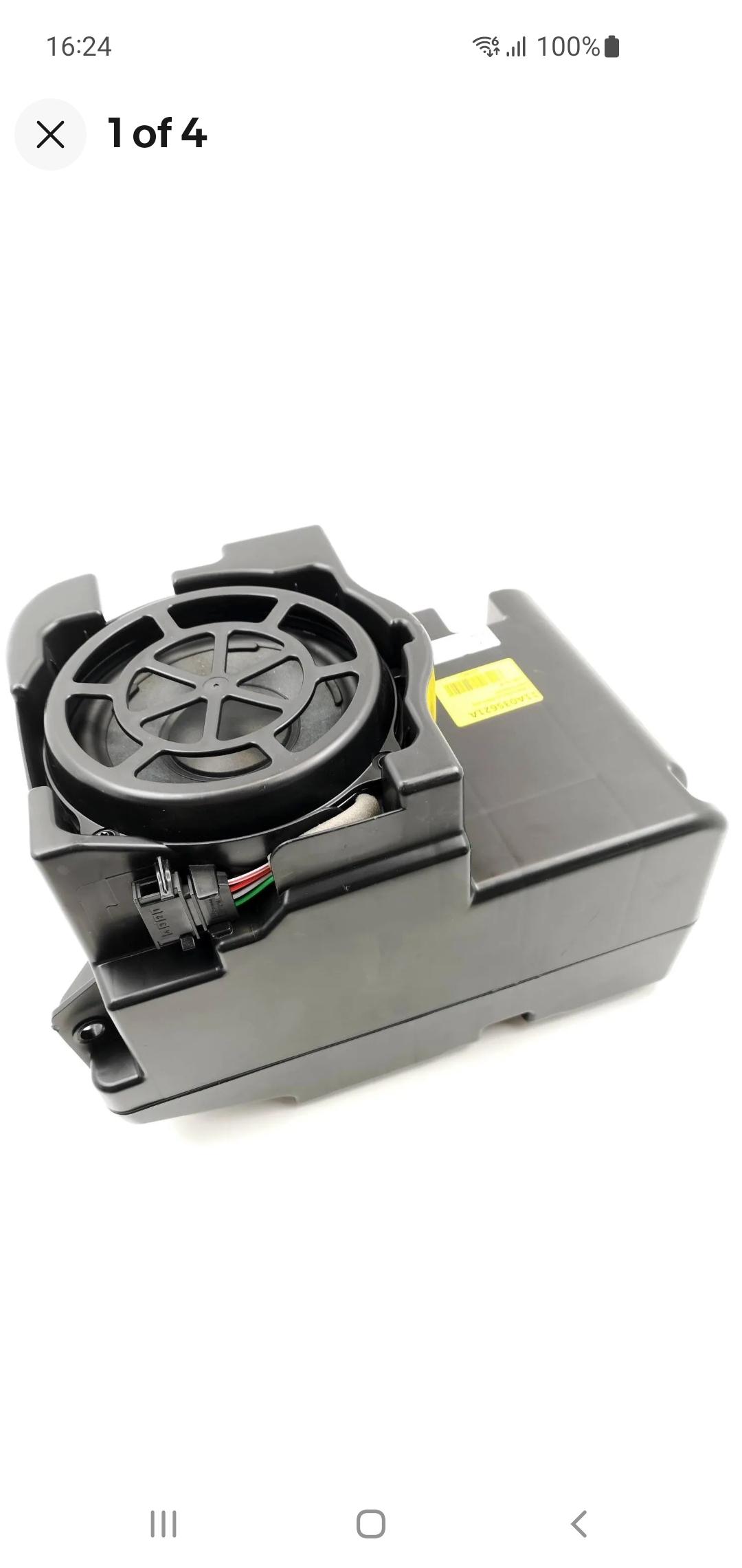

            The same Subwoofer is used in the Audi Q4 E-tron as part of the Sonos hifi system & VW ID4 as part of the Harman Karden system. There’s not any complaints there, only praise for the subwoofer!
            Subwoofer2
            Subwoofer1
            • This reply was modified 1 year, 7 months ago by Avatar photoSolymar.

                    There’s a lot of discussion on the various Skoda,VW and Audi forums about the quality with some saying it’s great, some not much of an improvement over the standard system and others saying it’s really poor.
                    As an audio engineer in a past life, I worked for NEAL Ferrograph, I know what a decent system should sound like.  I’ve had upgraded systems in previous cars and this is not one of the better ones.
                    Fitting a subwoofer inside a plastic box, then burying it in a close fitting metal well with nowhere for the sound to escape and covering it with a thick sound deadening polystyrene box and a boot mat is a really bad design.
                    Putting it in one of the side recess’s in the boot or under a seat would give it a much better chance of being heard.  Even on +9 the front door speakers almost completely drown it out.

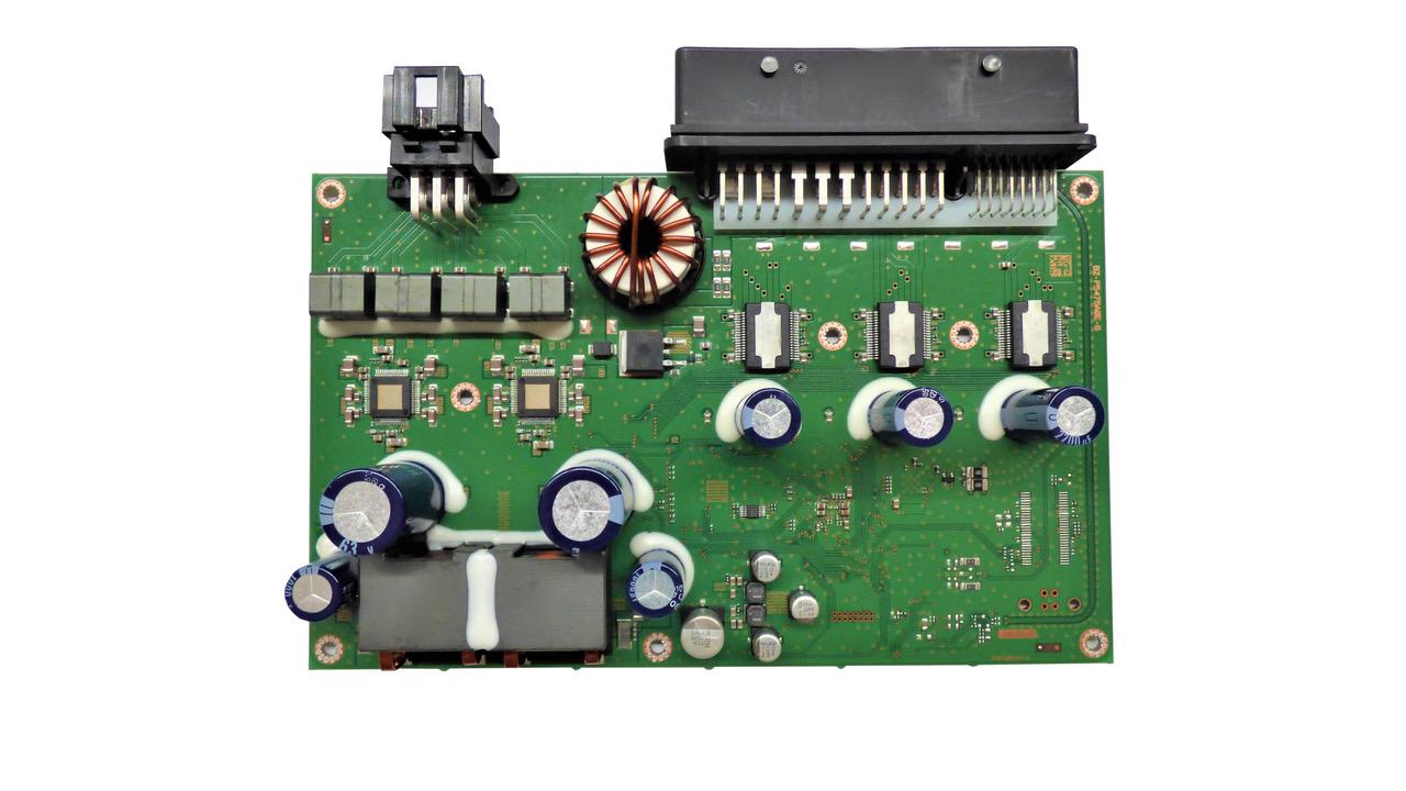

                                                In all ŠKODA cars, the amplifier processes the audio signal, converting it from digital to analogue and then amplifying it. (skoda story board 22/6/22)
                                                (If you can call it 16ch that is) PCB from top of Amp….
                                                Only 11 channels are used on the Enyak and likely the full 16 channels on the Superb. There is consensus that there are 7 chips on the board, of which from looking at least some of them appear to be generic SSOp36 chips, which are often seen in class D Amps.
                                                There is talk on the internet 2 of these are TDF8599CTH and 3 are 75610DAA however, I can’t say for sure.
                                                The issue appears across all models of the Skoda range fitted with the optional Canton sound. The overall consenus is there is no actual fault with the system other than the sub polarity is wired incorrectly with either + – crossed or the wiring is revered at the factory
                                                1 2 3 4
                                                4 3 2 1
                                                However at this stage whils’t @Phaedra is still actively in discussion with Skoda UK, it is not worth tampering with the plugs or wiring. Once Phaedra knows where he stands we can look into getting the same plugs and making a short wiring harness to connect in between, so not interfering with manufactures wiring but reversing connections where required. My neighbour 4 doors down has the same issue on the 80x so will be testing this out when the weather warms up a bit.

                                                  Avatar photoSolymar
                                                    Like I’ve said previously, on the Kodiak & Superb forums they have solved the problem by flipping the plug 180deg. Now whether that’s actually physically possible I don’t know but that solved the issue. They may have swopped the wiring over as Kezo states. The loom wires look to be all white sheathed so I would imaging it would be an easy mistake to make in manufacturing, hence the connector plug to the subwoofer being the wrong way around! Time & testing will give the answer!
