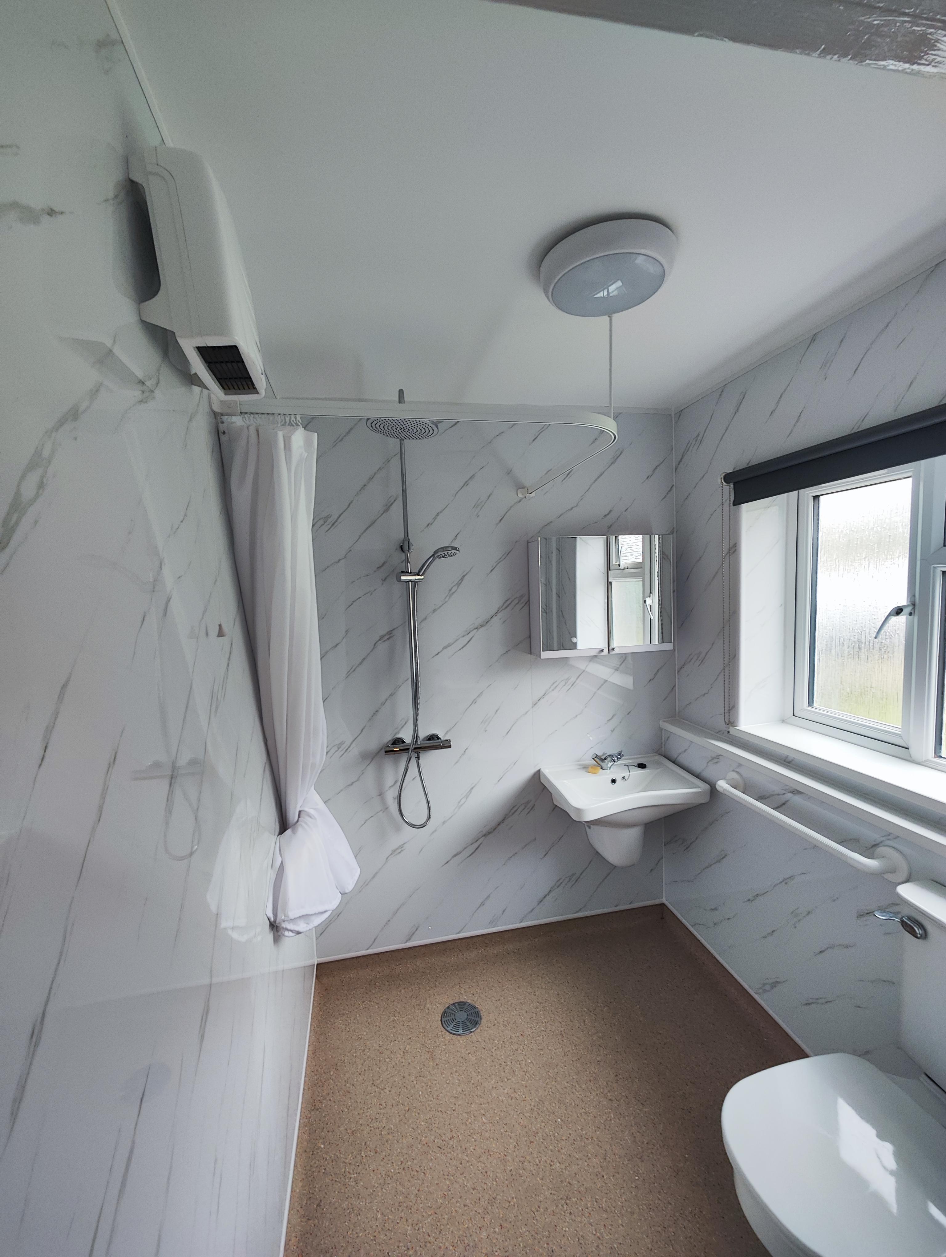

Omg where do I start with this. Had the OT out and they agreed to fund a new wetroom.
Housing association prices it up at £12,000 plastic panels marble effect on walls instead of tiles, new shower not electric, Concave sink so nice to wash at and a taller WC, take radiator out and put fan heater in.
10 days with no bathroom luckily our toilet is separate as this is an additional loo. Workmanship is awful you can see a gap between every panel join where he hasn’t gotten them together properly Inc one right behind the shower.
They’ve put a broken panel up, they cut them on the grass so there’s mud on them, light switch has been cut to chest height, our clothes pegs outside have been put in the drain for some reason.
They pulled one piece of coving down replaced it with a bit that doesn’t match and fitted with wood screws, there’s more too
There was a sink next to where the loo is going so they were just going to leave all the pipes there and put a huge box over it, after a big row they cut it all out and the box is now 6 inches square instead of several feet.
They put the sewer plumbing in for new toilet and from Thursday put toilets were backing up the inspection chamber was full of sewage to the top by today so guessing they screwed that up or big coincidence.
I was looking forward to a nice wet room and just wanna cry over the stress of it all now
As far as I’m concerned they can rip it out and start again. We didn’t want the Ha doing this as we knew this would happen we begged the council to get quotes from private bathroom companies
