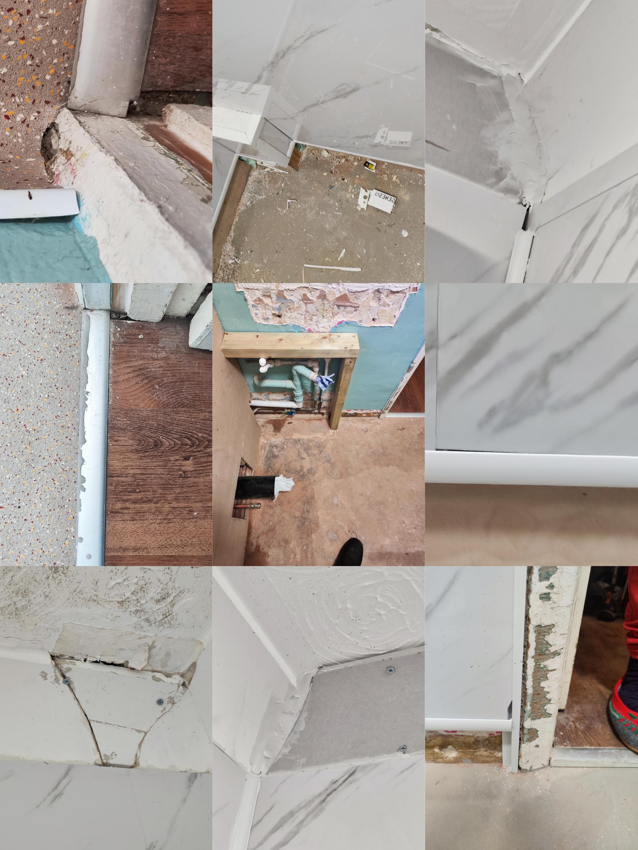

      Omg where do I start with this. Had the OT out and they agreed to fund a new wetroom.
      Housing association prices it up at £12,000 plastic panels marble effect on walls instead of tiles, new shower not electric, Concave sink so nice to wash at and a taller WC, take radiator out and put fan heater in.
      10 days with no bathroom luckily our toilet is separate as this is an additional loo. Workmanship is awful you can see a gap between every panel join where he hasn’t gotten them together properly Inc one right behind the shower.

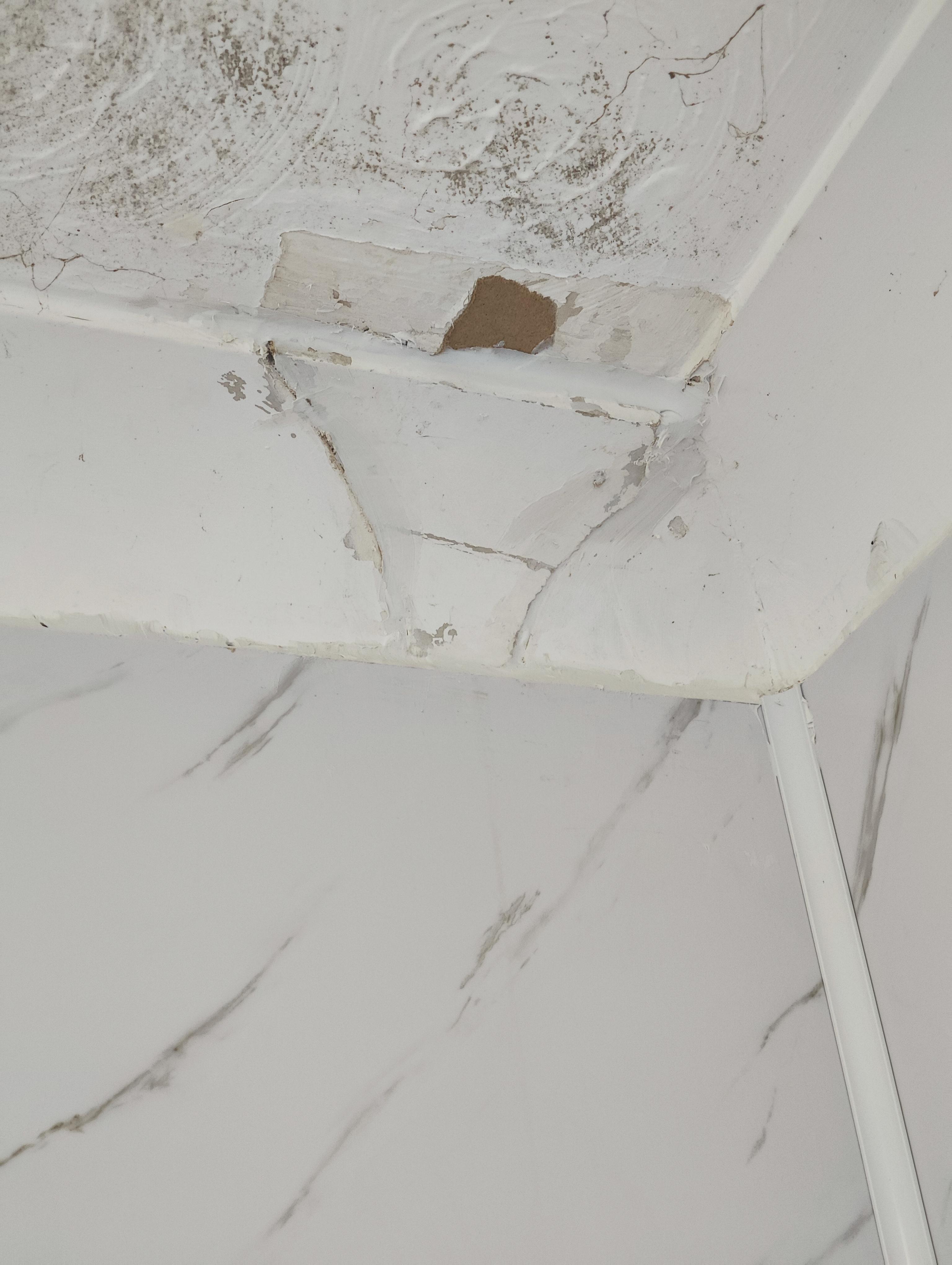

      They’ve put a broken panel up, they cut them on the grass so there’s mud on them, light switch has been cut to chest height, our clothes pegs outside have been put in the drain for some reason.

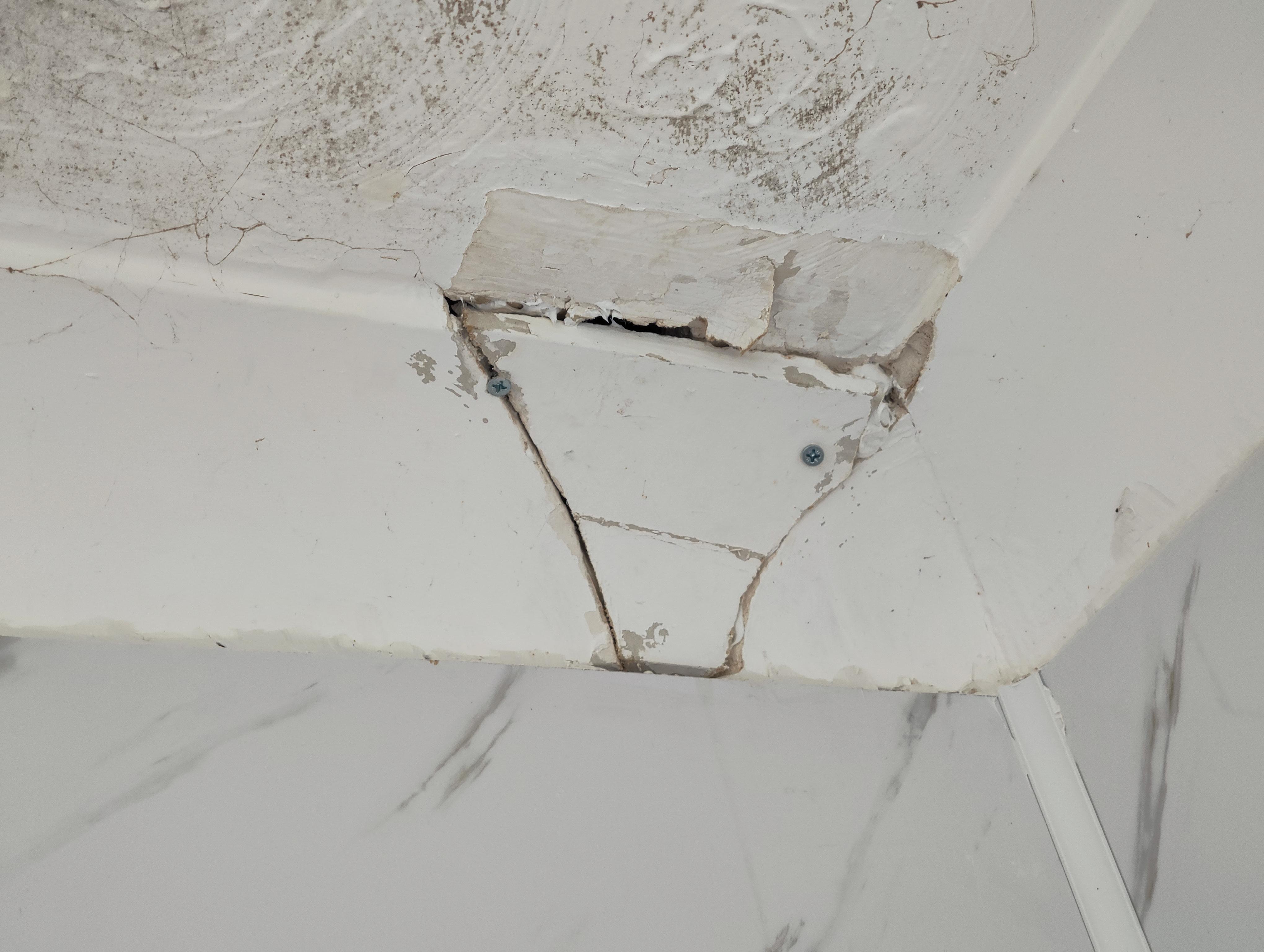

      They pulled one piece of coving down replaced it with a bit that doesn’t match and fitted with wood screws, there’s more too
      There was a sink next to where the loo is going so they were just going to leave all the pipes there and put a huge box over it, after a big row they cut it all out and the box is now 6 inches square instead of several feet.
      They put the sewer plumbing in for new toilet and from Thursday put toilets were backing up the inspection chamber was full of sewage to the top by today so guessing they screwed that up or big coincidence.
      I was looking forward to a nice wet room and just wanna cry over the stress of it all now
      As far as I’m concerned they can rip it out and start again. We didn’t want the Ha doing this as we knew this would happen we begged the council to get quotes from private bathroom companies

            Oh dear Rich what a mess but, typical HA / LA standards I’m affraid.
            Why did they remove the radiator and replace it with a fan heater, that will be expensive to use? Most wet rooms I have first & second fixed are fitted with a towel radiator in place of a normal rad!

              This is after yes plastered that hit of coving now too 9 days so far….

                There’s no way that’s £12k worth of work there.
                #258131

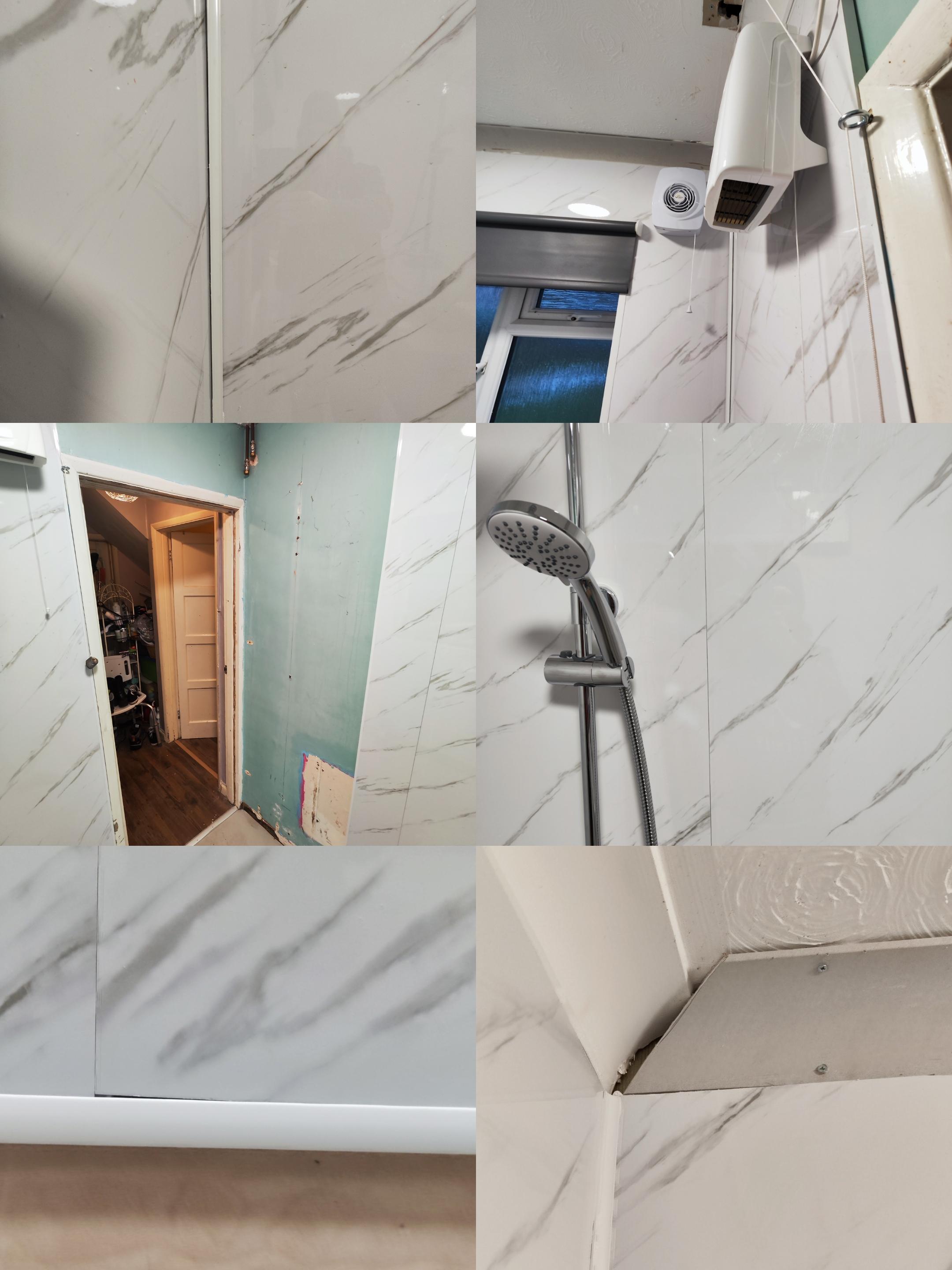

                  Even the white corner beading on the panelling isn’t fitted right – just a blob of silicone here and there by the looks of it!
                  In yuor previous photo the panel is cut short of the end bead, then there is that bit of coving thats not flush and wow why use but up 5″ coving to 4″ is beyond me. At least they could renew it all or do away with it.
                  I’d be complaining to the LA and for warning them you won’t be signing it off.

                    Yeah I’ve already made the LA aware she’s coming out Thursday to look.
                    I know it’s crazy what they’ve done. You can’t see it in the pics but the edge of the plastic along the coving is so far off straight it beggars belief. I could’ve cut it straighter than that.
                    There’s no sealant along the lower edge where the shower is so over time no doubt that’ll wick up behind the plastic.
                    I have no idea why they didn’t just pull all the coving and panel up to the ceiling.
                    Thanks for the replies I didn’t want to just think it’s me being fussy or over picky but it’s the one chance I’ll get to have a nice shower room so want it to be nice to last the next decade or so.

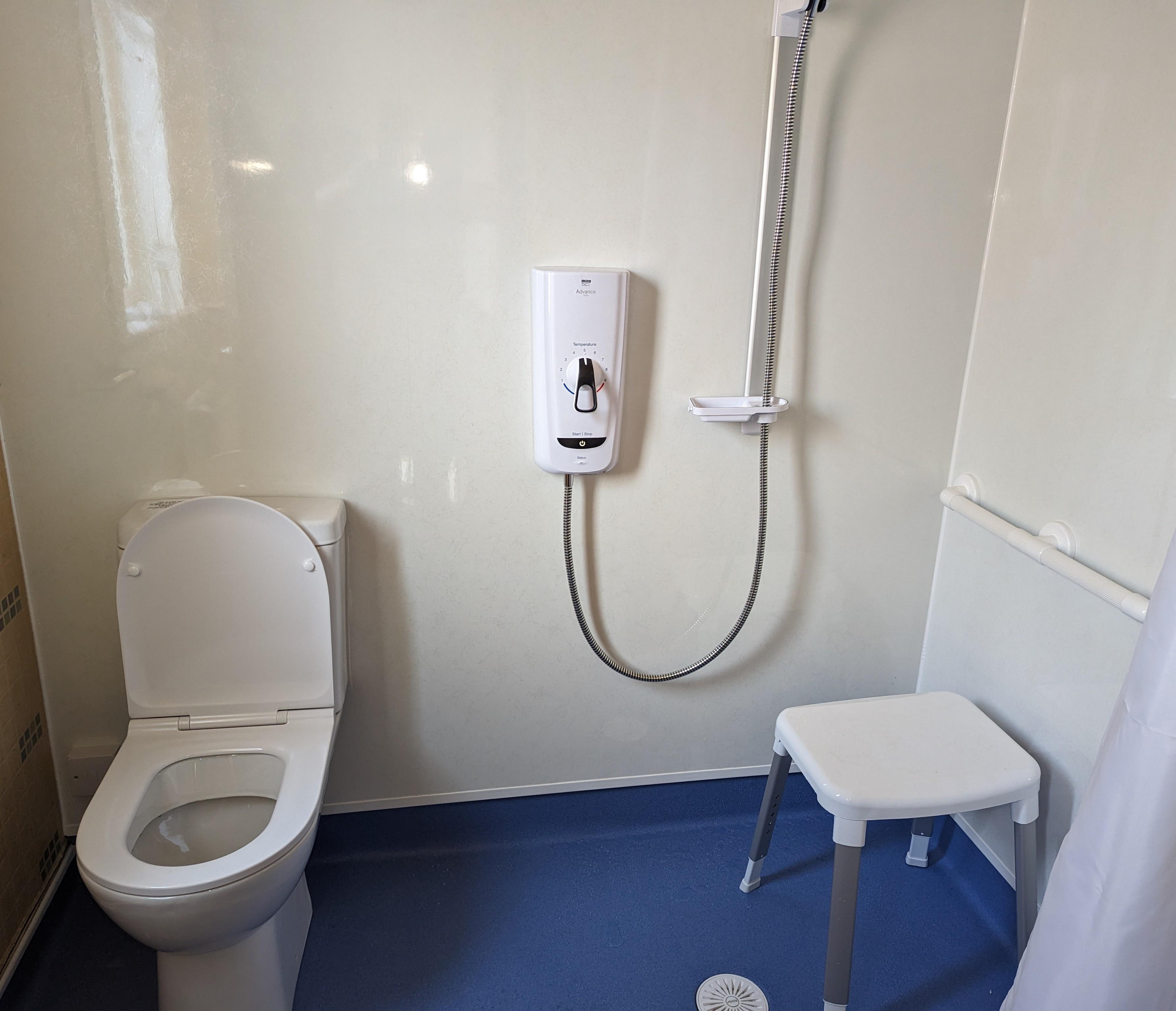

                    We asked for nothing to be on the floor to make cleaning easier and got a normal floor mounted loo and sink with pedestal. The HA tried changing the plans twice and caught them both times. They had bought a “normal” rounded sink and I specifically said I want a doc m Concave sink so I cannot at it right up against it and I checked the boxes and caught them out.
                    Just can’t believe they quoted just under 12k for this mess. I had a private quote for pocket door, floating toilet and wall no pedestal sink for ten grand but council wouldn’t go for it.
                    Thanks for the comments it’s really supportive and helpful. I just feel like I wanna burst into tears all the time we’ve been waiting over a year for this and now this shambles 🙁

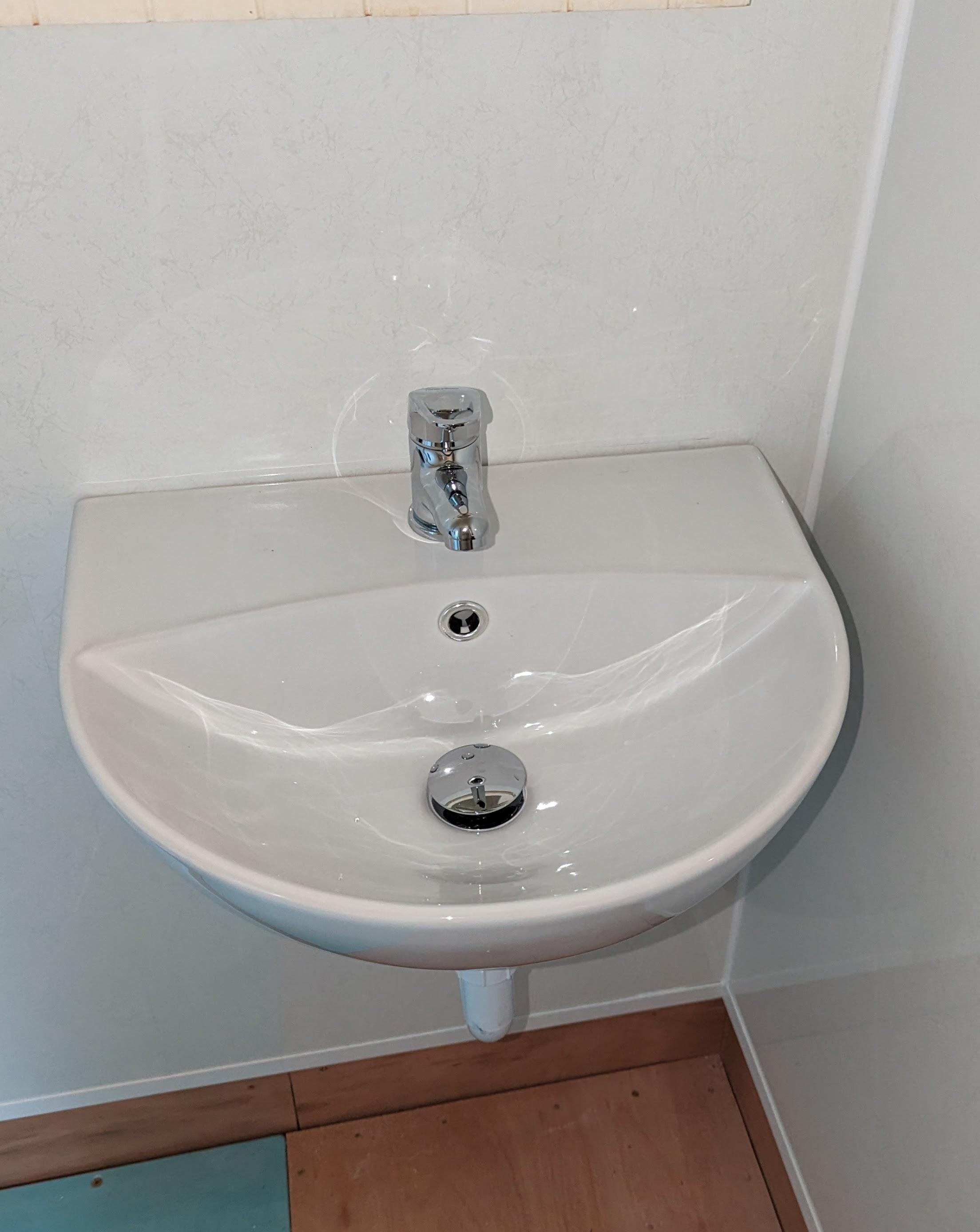

                      You can get a wall hung toilet for not alot more than a floor standing one, same with the sink.

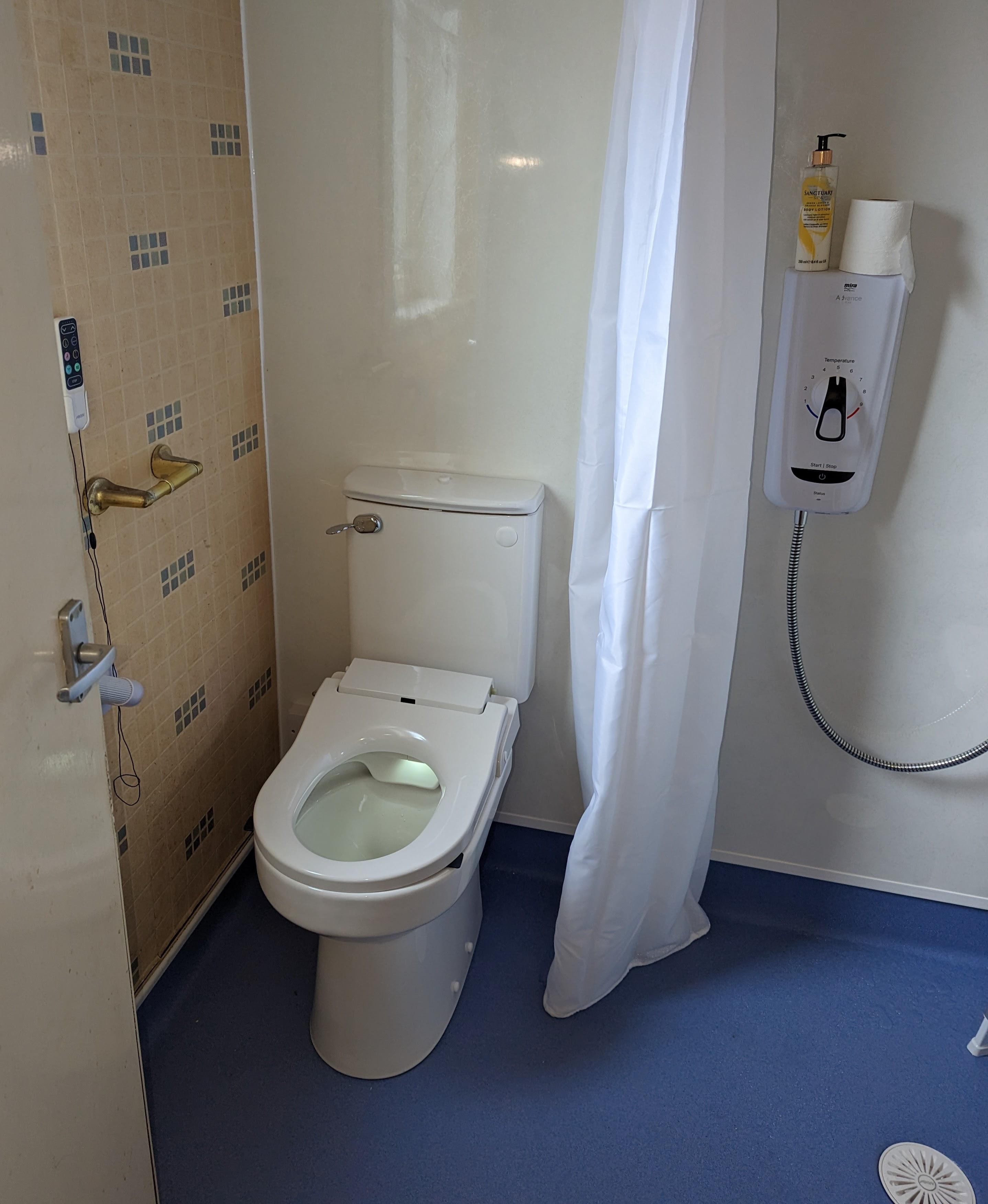

                        ghastly work; certainly not pros…
                        my housing redid my whole bathroom with new wet system and bidet toilet for a lot less.
                        this is it, not fully finished,
                        not fitted the bidet and one wall to be done..

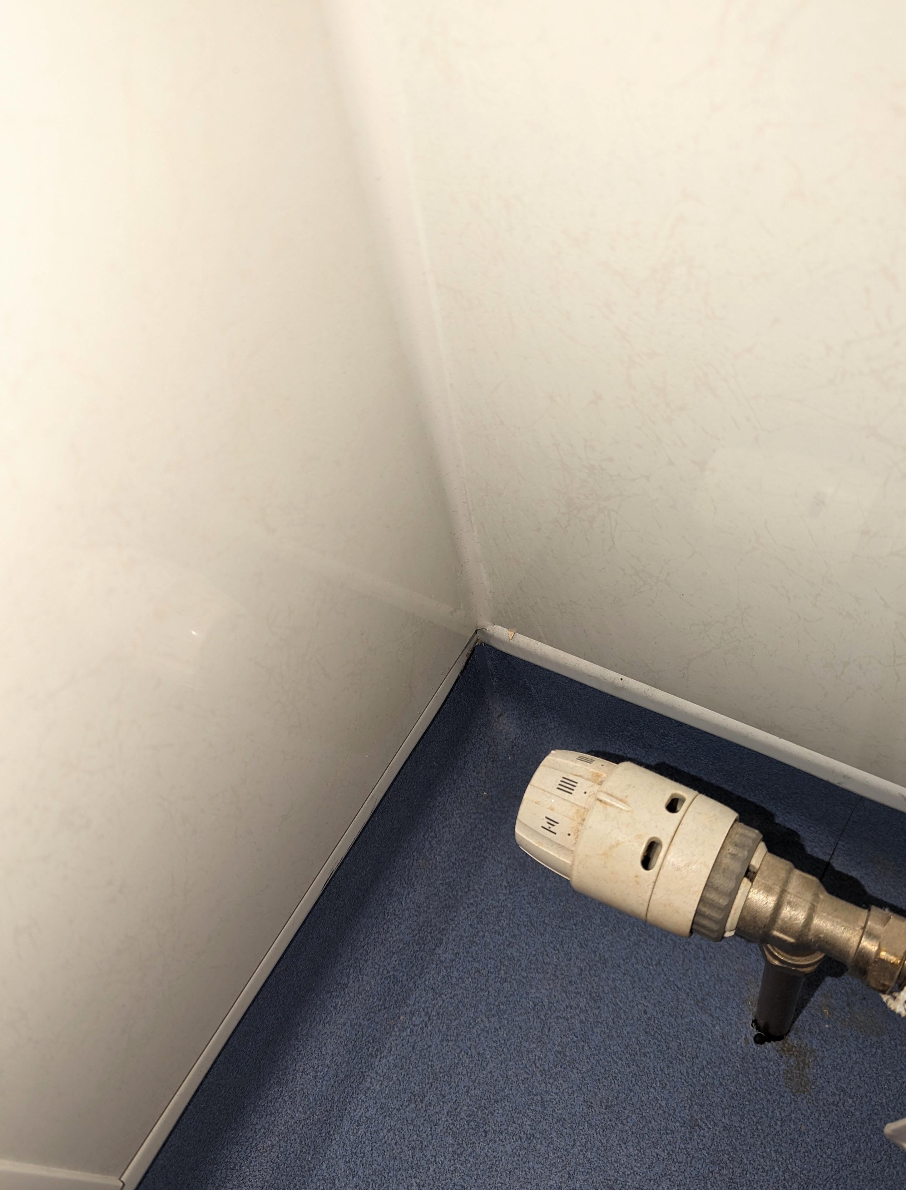

                            Rich are they fitting the anti slip flooring typically seen in wet rooms and similar what @struth has and provides a fully waterproof join between floor a wall?
                            I bet they haven’t even tanked the floor or walls!
                            @Struth
                            can you take a close up of the corners where the panels join?

                              have to say the bidet toilet seat is the dogs danglies. how i ever managed without one i don’t know. lol
                              not cheap but they take up no more room and are fab.
                              yes kezo ive the waterproof flooring. there is a plastic pan under the floor  around shower which is contoured to drain water into drain and the blue flooring is non slip/waterproof and easy clean . got handrails and a fancy sink too. shower curtains on a quality rail[2 rails actually] too. the wall finish is solid and not cheap but really finishes it off

                                Yeah theyve put non slip wetroom floor in but they screwed up the latex as there’s high spots and low spots.
                                If I spill water in front of the sink from washing it just pools, spill enough and some of it will run to the drain.
                                Infront of the loo it’s up and down, run your hand over it you can feel it.
                                To be honest I just feel I want to tell them to rip it all out and chuff off.
                                When they pulled the uPVC away from around the window turned out there was nothing there between the window frame and the wall all around. When pointing was redone they fitted metal lintel and nothing around that, put my hand up there and was so cold water was pouring off it.
                                They claim they’ve spray foamed it all now and there’s some green foam around but dunno if they put enough in. That’s explain why it was always cold in there. I could literally put my hand in the gap and touch both sides of the cavity walls at least there was insulation in there further down.
                                So even the window fitters and pointing guys screwed up too.
                                Id love to ask these people now you’ve finished would you be happy with that work in your own home? If not don’t do it in mine. We intend to stay here for the rest of our lives (touchwood)

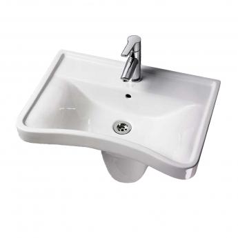

                                  This is the sink I specced it’s lush

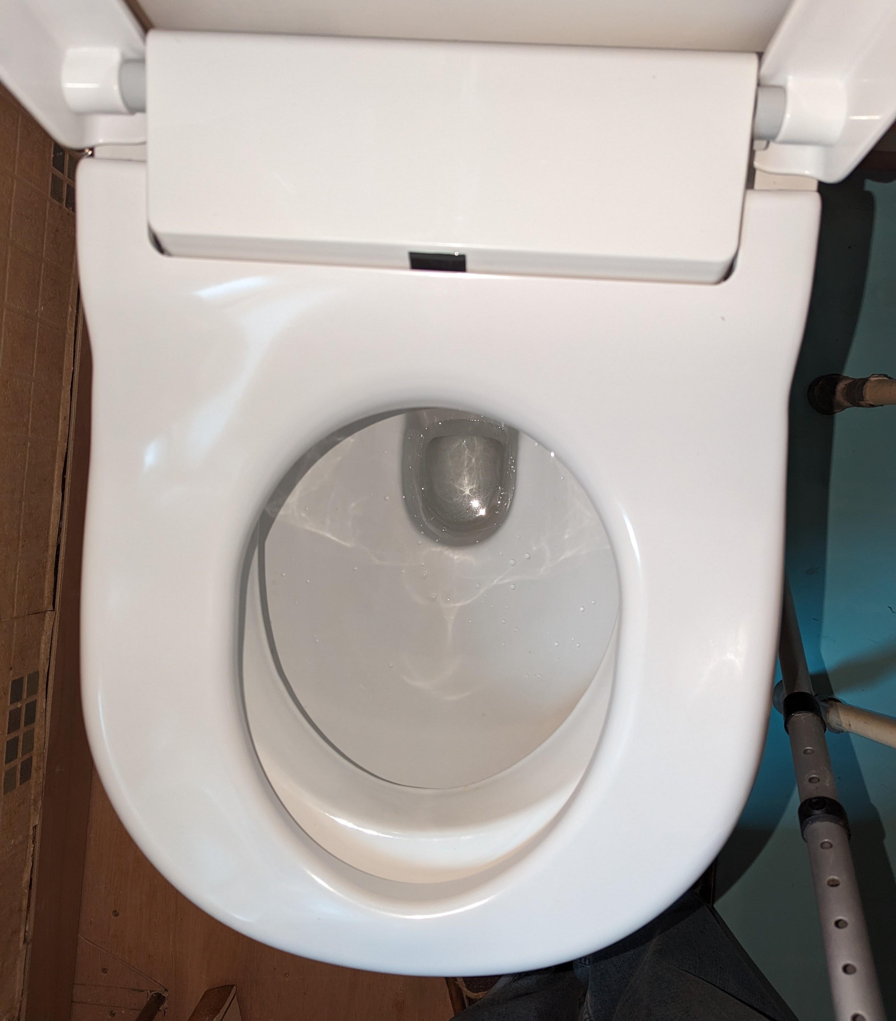

                                    Oh I thought I was gonna get that bidet seat as there was a box with that on it so I got super excited but then realised it was just a box that’d been used to put some handles and shower curtain etc in, gutted.
                                    I might ask about it on Thursday tho it’s only £900. Can’t believe how easy it is to do wall hanging toilets frame in the wall 12cm deep, put plastic panel over and hang loo on bolts so dunno why that was impossible too

                                        the wall joint are near invisible. thats the worst one

                                              the bidet even has a light inthe bowl so you can find it in dark.. the water line to cistern just gets a 2 way adaptor fitted to convert the line into to flows. an electrician fitted a supply neatly at bottom corner behind the toilet.
                                              the 2 lads fitted most of it themselves in 4 days. just had a spark pop out a few times. 1 a plumber and other did the wood etc. nice lads they were and as i was disabled the girl who runs the team got them to do the other wall to make it look classy.
                                              net cost to me?  best i don’t say lol
                                                  you can sort of see it here during consruction
                                                  #258184
                                                    Yes @struth can see it 🙂
                                                    So it a loo and Bidet in one?
                                                    #258187
                                                      Yes @struth can see it ? So it a loo and Bidet in one?
                                                      yes its a normal toilet really but you take seat off and fit the bidet seat in place of it. not all bowls can take a good bidet seat. this one does. in fact first bowl was a bit small so they changed it for a bigger one. its got a slim tank too. its remote controlled too, and has sensors on it so it wont go off if your not on it..lol
