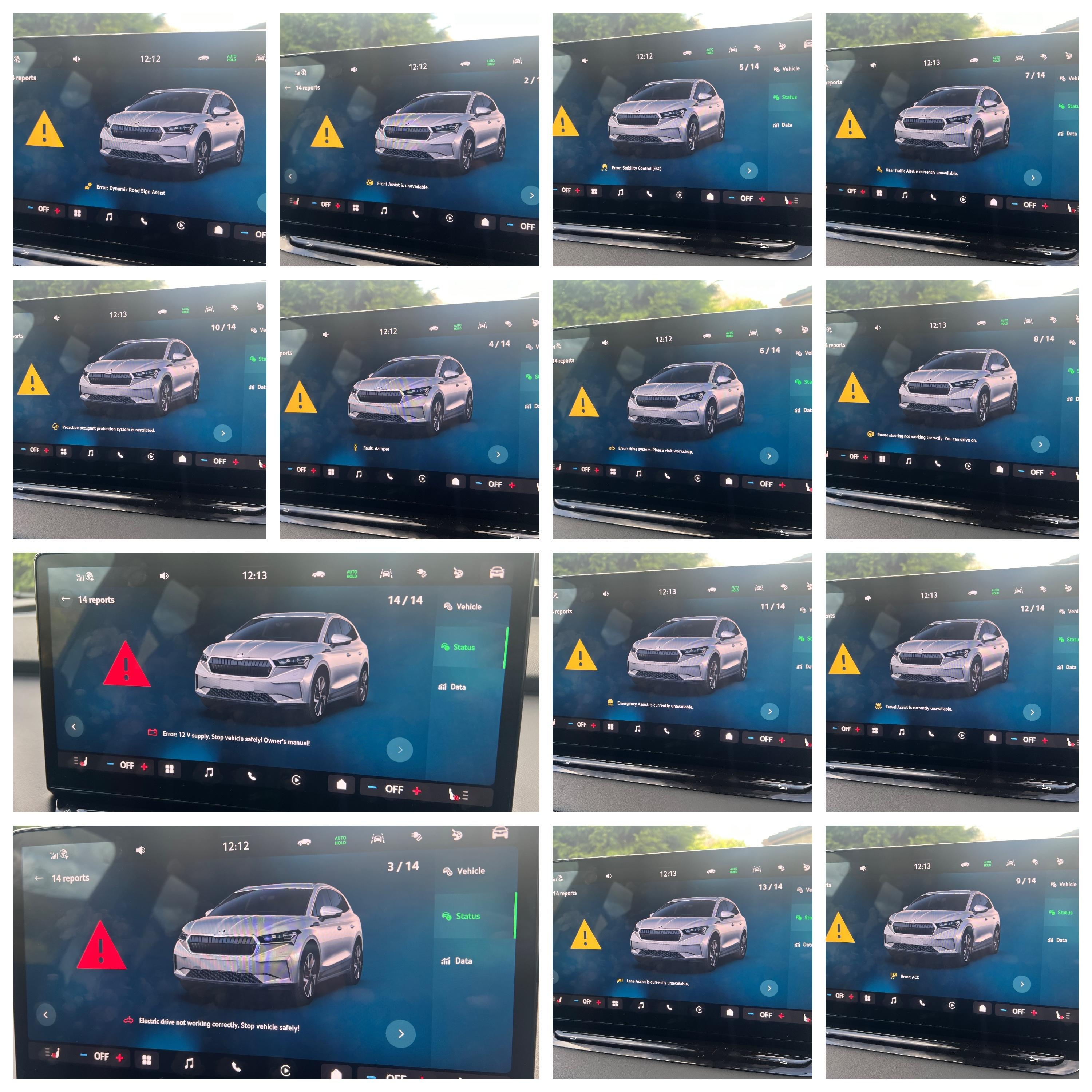

                  Finally got my Enyaq 85 looked at yesterday at dealers due to random error message’s ranging from speed sign recognition malfunction, sos malfunction, rear parking sensors malfunction, rear collision assist malfunction, left rear indicator malfunction and 12 volt battery warning to name but a few. Most have just randomly appeared over the last few months then disappeared! My real gripe was the easy access system not returning my seat to the correct position! It only got it correct about 50% of the time. Got call from dealer and apparently all the issues relate to the 12 volt battery system. A new battery and other parts have been ordered but they are on back order and don’t know when they will be available. They have charged the 12 volt battery to keep me mobile. No errors this morning and seat moved to correct position😃 took child to school and got in and seat wouldn’t move automatically again! Dealer said car is safe or they wouldn’t let me drive it. Just hope this isn’t the start of difficult journey. I did google about the 12 volt battery on Enyaq and apparently the dealers had to replace the 12 volt battery when they were doing a software update due to issues but thought this was all sorted for 2024 model but it appears not or I’ve just been unlucky with a faulty battery.
                  Sadly the issues still exist as mine is having some of your problems amongst others, cars been at service centre approaching 7 weeks with parts on back order also and no idea when they will arrive.
                  I had error messages a few hours after collection which they suggested was 12v battery however it’s been a number of parts need replacing, hope you get a quick resolution.

                                Had errors once home after collection ,they did vanish after a few hours then returned day after. Errors again after maybe 4 days then vanished Ā after a few hours again, by this time I was worried about using the car and where I was parking as one of the warning was in multi-storey car park which I knew would be a nightmare to get car recovered.
                                Day 6 car wouldn’t select drive or reverse and finally gave up with too may errors, recovery guy came and couldn’t get his diagnosis machine to connect to car so gave up and said he would arrange recovery with specialist truck the following day.
                                Heard nothing for 2 days and phoned motability to see what was happening and recovery bloke had marked the job as completed/fixed, so motability then arranged courtesy car and for recovery of car.

                                  Im fairy patient and understanding but I really can’t fathom how the wait for parts can be so long, they are producing cars and shipping them in a shorter timescale than mine will have been in for repair.
                                  If parts arrive on time, the car (5 days old) would her been at the service centre for 3 months. There is just no urgency in fixing a very expensive and literally new vehicle.
                                  I realise these problems happen but Skoda support have been hopeless, when I phoned for an update they said the car had not even been inspected but I knew otherwise and the app had been telling me doors/bonnet etc had been open a number of hours.
                                  Just for reference mine had 14 issues at the last count. That’s besides the smaller faults such as stuck charging door, temperamental electric seat, etc
                                  Hopefully it’ll be fine after being fixed but I’ve a feeling it’s going to be one of those troublesome cars.

                                    Sadly we had a poor start to Enyaq ownership, car had errors day after collection.
                                    Mainly 12v battery warning and electric drive error, car would not go into drive.
                                    Managed to get car going after locking/unlocking, turning car off/on for maybe an hour as we were in middle of nowhere so would have struggled with recovery.
                                    Nearly one week later and same problem but car would not move regardless, had to be recovered with loads of errors now appearing and has been at service centre for 3 weeks awaiting parts which may take up to 8 weeks.
