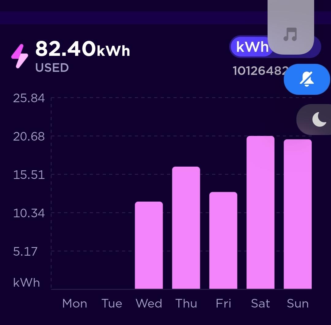

                                      Interesting to see these new high temperature heat pumps designed to work better in older homes.
                                      Having said that our Vaillant Arotherm has been brilliant it’s on its own no hybrid and the house is 1930s semi right at North facing coast so we do tend to get blasted at times. House sits at whatever we set it to thru winter we were doing around £5-12 a day for all electricity for everything heating, water plus day to day. That £12 was just the occasional day where we probably turned the heat up more lol.
                                      My only concession is I have a free electric throw from Octopus and sometimes I get super toasty under that but that’s more on me having a wonky thermostat than the house.
                                      Yup definitely want weather compensation too. .
