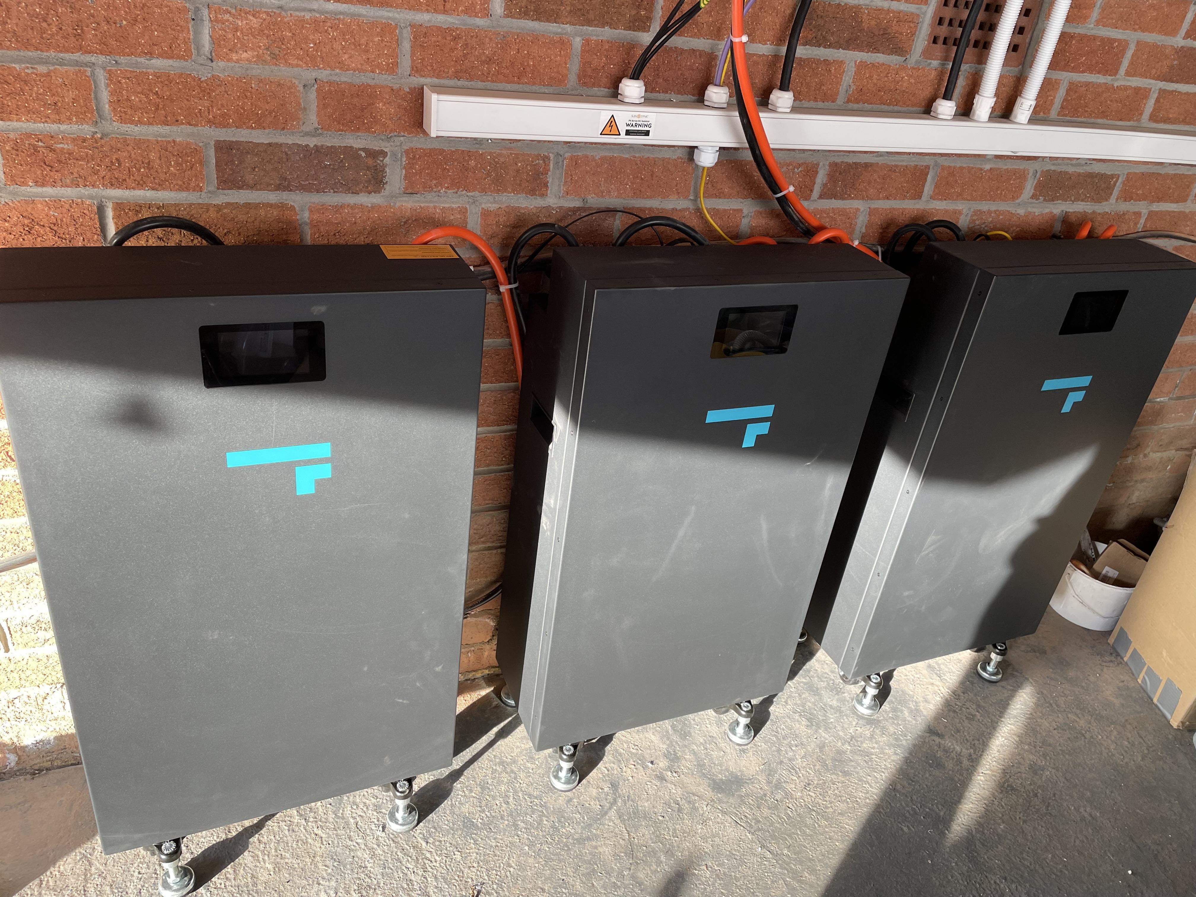

                                                Here are the little beauties.
                                                #305443
                                                  Not a bad looking install at all mate and not too industrialised.
                                                  For longetivity Iwould stick with 20% DOD.
                                                  Are batteries balanced now?

                                                    2 of the batteries are within a Kw of each other the other one is typically 3/4 kw less. I’ve been told the best way to balance them is to fully charge them to 100% and that will do the trick. Unfortunately getting to 100% full on Octopus Go, 5 hours of cheap overnight charging, is proving difficult so looking to move to Eon until I get an EV and charger as Eon gives more hours overnight.

                                                        Did you increase the charge rate based on calculation I gave, so not to overload main cutout? However, I find EON nextdrive a better tariff overall, as the peak day rate is discounted in the deal and not at the price cap Octopus charge!
                                                        Maybe hold off/part discharging a couple of days, to get them float to 100% over the a couple of nights, it’ll be better in the longrun.
