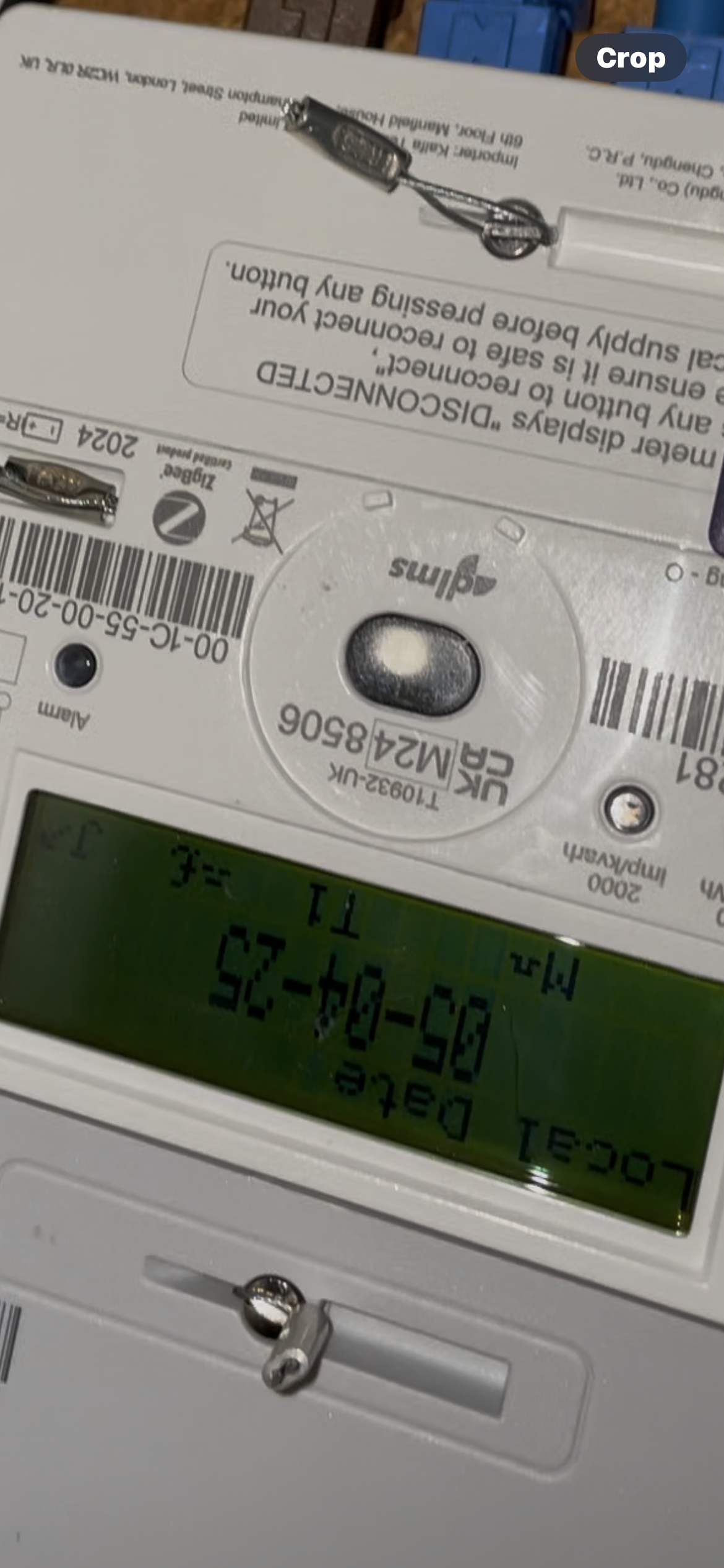

              My initial assertion that the inverter problem only coincides with charging the car turns out to be bo££0&s. I’ve put the washing machine on and the inverter has stopped recording.
              The photo below shows my smart meter reading at the same time as this.

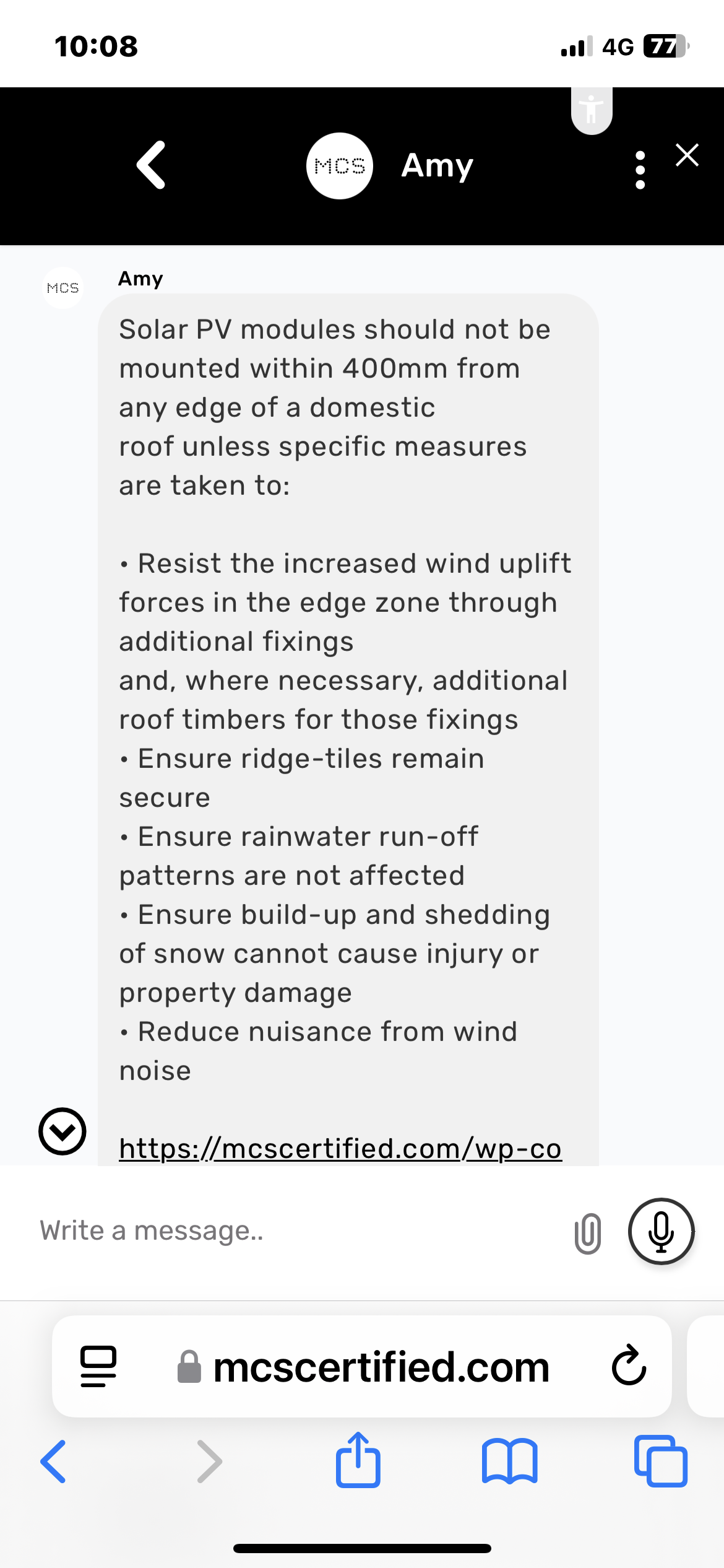

                                              @Kezo, have you any experience with fitting solar panels within the MCS guidelines of 400mm from any?roof edge such as ridge tiles or gutter tiles.
                                              One of my array is a triangle which means, if using the 400 mm distance guidelines from MCS, a reduction in the number of panels that can be fitted as even a corner of the panel would need to be 400mm from a ridge tiles.
                                              I spoke to MCS today who confirmed there are ways around this 400mm distance. This is what they wrote.

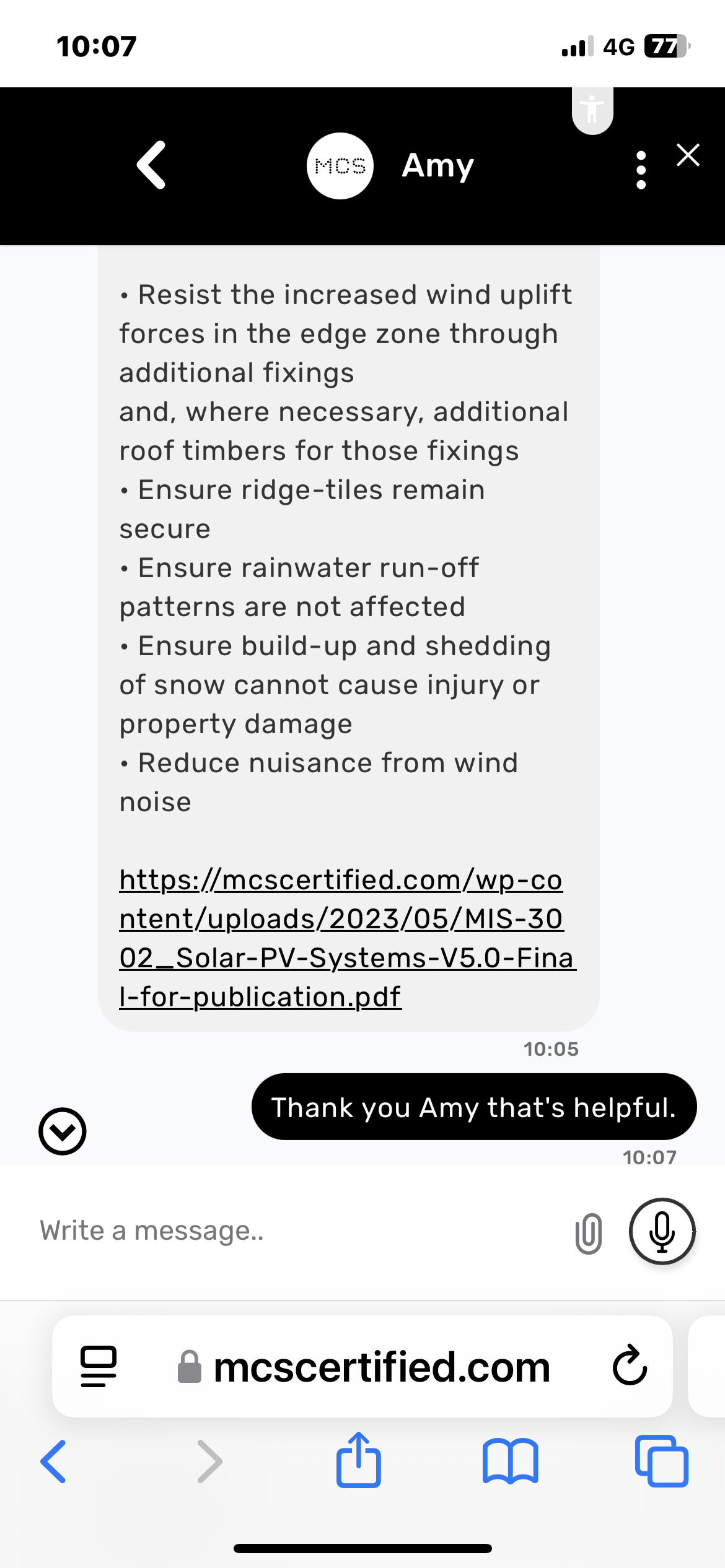

                                              #304413

                                                    @kezo, to put a bit of meat on the bone so to speak, my existing FIT payment panels are 16 panels split over two roofs, 8 panels on each. The existing panels are smaller than any new panels I will be using to replace the existing.
                                                    My installer is adamant that he won’t fit any panels within 300mm of an edge. This will reduce the number of panels I can fit on each array, from 8 to possibly 5, maybe 6. However if he follows the the info from MCS above, ie use more fixings if the panels are closer than 400 mm from an edge, he would be able to get 8 panels on each array.
                                                    I was just wondering if you had experience of using additional fixings to secure the panel rails and if so what does this actually look like ie how many additional brackets, how close does the bracket need to be to the end of the rail.
                                                    Not sure if all the above makes sense but basically it’s a fixings issue about holding down the rails when panels are closer than to the edge of the roof and according to MCS the minimum distance, without additional fixings,  is 400mm, which to my mind is way more than necessary.

                                                      The closes’t I have gone is 174-180mm from plane of a pitched roof, where an additional 2 extra rails from memmory were installed and the owner (a carpenter I new from site) strenghened the rafters by spreading the load of a 80’s 3 bed detached. Normally I would not go closer than 300mm which corresponds to what your installer is saying. On a hipped roof you need to pay particular attention on distance away from the sloping ridge tiles.
                                                      Its not simply a matter of additional rails, you need to know if your rafters will take the additional wind pressure, without causing stress damage to the roof or the PV module, as the uplift in the edge zone can be 3- 4 times greater than in the centre. The other issue going 200mm from the edge, risks rain overshooting the gutters.
                                                      There is a fairly simple calculation (Qp x A x Cp x SF) for wind uplift and the requirement of extra fixings and whether the rafters require any additional strengthening, which your installer should be aware of, as a member of one of the two electrical bodies (I will find something easy to explain).
                                                      Not having seen your roof, its hard to know but, yes there are possibilities of extra rails would surfice however, its how adamant your installer is and whether he would take responsibilty on MCS’s say so or not. MCS recently downgraded wind up lift and you’ll ofter find building/planning guidence is often contridictory to that of the MCS which doesn’t help.
                                                      #304448
                                                        @kezo we’ve swapped emails for a good deal of this afternoon and he thinks it will be fine to have 8 panels on each array. He has based this on a panel size of 1722 x 1134 which is a bit limiting but at least we have a “bit” of an agreement. He has software that works this out for him so lets hope its accurate. How much money do you want to bet that its not lol.
