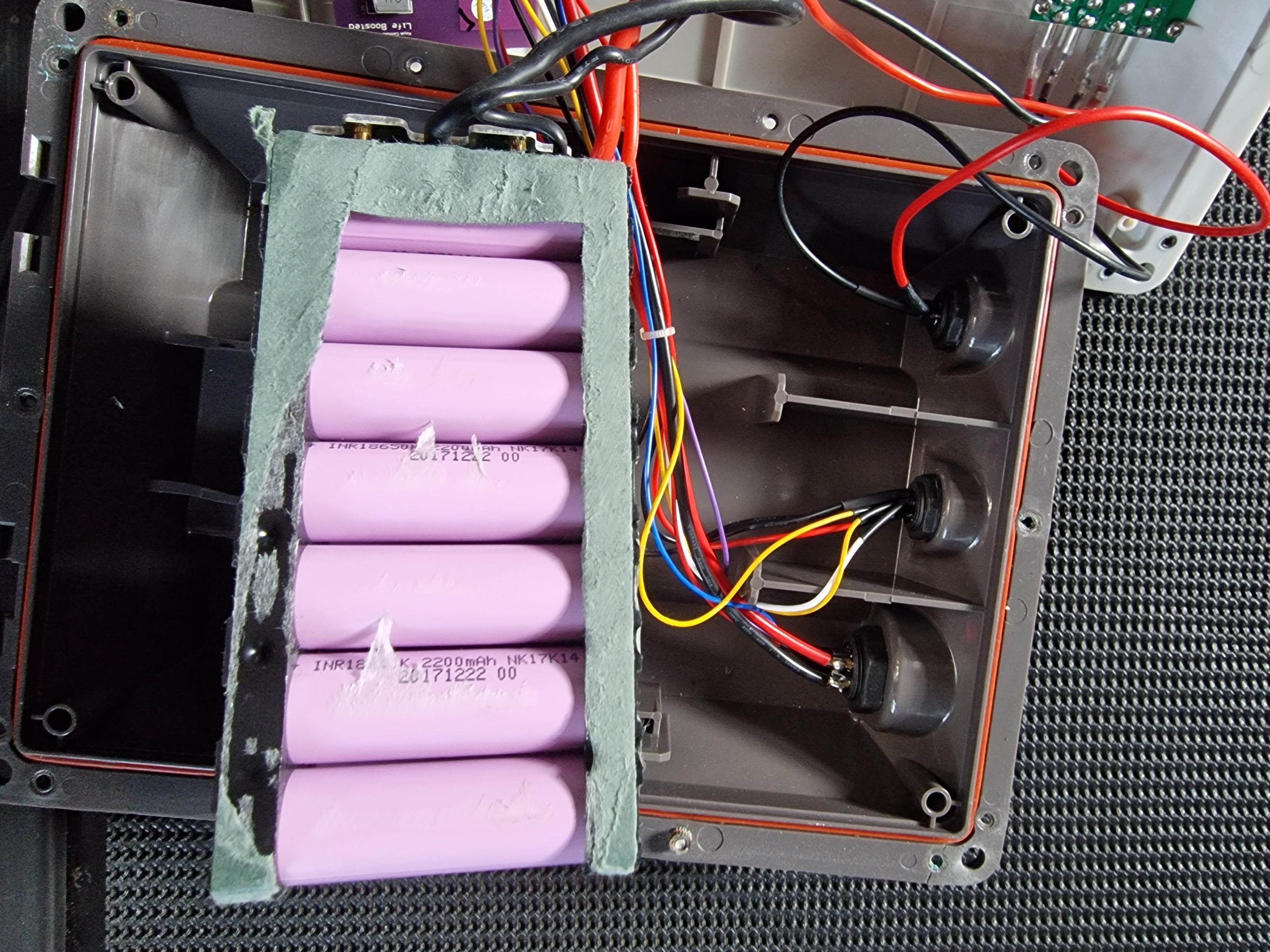

      Does anyone know anything about batteries?
      Occasionally I still manage to do kayaking, although I can’t paddle so I use a Bixpy electric motor. During the lockdown, I could not go kayaking so the motor and the battery pack sat in the garage. I went to charge it up and it is completely dead and will not charge. I just did not realise that you had to keep these types of batteries charged like a car battery.
      I tried the supplier of the Bixpy battery and motor and they only sell the complete kits so I tried Bixpy themselves who are based in the USA, and a new battery is $599 dollars. Even If I could afford that they will not ship to the UK so I am stuck.
      I have opened the battery pack up to look at the batteries thinking that I might be able to replace them but it’s not just a battery pack, it has the auto-shutdown function if you get separated from the kayak and the remote control mechanism in there. So there are wires everywhere and it’s beyond me.
      Does anyone know if anything can be done with it please?

        Post a picture if you still got the battery pack opened.

                  I am away visiting friends until next Sunday so I will post pics of the battery pack open when I get back.

                    I’ll help you out in that part, what you have inside the charger is a 7s6p (7x series, 6x parallel) 18650 brick, 42 cells in total. Each one 4.2V 2200 mah, for a total of 25.2V, 13.2AH/332Wh.
                    Just get another one with similar specs (not less than 13AH/330Wh – more would be okay, and voltage needs to be 25.2 as well as 7x6p since we don’t know what the balance board/battery management in the battery is looking for).
                    I’ll have a look in a second myself, gotta pick up the wife first.
                    I think both Struth and Wigwam are irresponsible beyond belief, Struth suggesting a charger that’s not able to charge your battery in the first place, and Wigwam suggesting that the batteries are “recoverable” – they’re not. They’re irreparably damaged. You could get them to take charge again, but the damage doesn’t go away, that’s done and dusted – LiIon batteries take physical as well as chemical damage internally when deep-discharged, and that can’t be repaired since you can’t open those batteries. They’ll catch fire (violently so) at contact with oxygen.
                    Those are the batteries inside your pack, 42 of them. First rule in regards to anything to do with 18650s or 21700s: don’t screw with them.

                        #185884
                        Pirots
                          Battery pics
                          #185885
                          Pirots
                            I put various pics up but only the last one is there.
                            #185886
                            Pirots
                              #185887
                              Pirots
                                #185888
                                Pirots
                                  #185883
                                  Pirots
                                    Battery pics.

                                      @Pirots, I thinks a sensible question first is do you have any soldering skills and knowledge of Ohms law along with a multimeter?
                                      It is very possible the batteries within the pack are not completely dead and dropped to around 2.6V. It is possible to “jump start” the batteries but you would need a variable output power source where you set the voltage for the pack at 25.2V but up the current so the batteries would begin to charge and then allow your normal charger to takeover in the hope they recover. For safety reasons given the size of the pack an understanding of Ohms law would be preferable and then theres the cost of a variable power source or a larger charger, which could be money down the pan especially if the batteries are below 2volts. Use of a multimeter could determine the average voltage of each battery in the pack.
                                      You could refurbish your current pack by replacing the individual 18650 batteries but there would be a fair amount of de soldering and soldering involved, ensuring you don’t get any dry joints or apply to much heat to the batteries whilst doing so.
                                      Even if you bought a generic a generic 7s6p battery pack there would be some soldering, to solder fly leads on etc and the precautions with refurbishing your current pack would need to be taken into account.
                                      You could ask an electrician or electronics engineer to refurbish your current one or fit a generic 7s6p and do all the soldering for you. But it could prove costly this way unless you new someone.
                                      Its not difficult to do, but its easy for me to say that as its been my trade for nearly 40yrs. If your confident and would like to have ago and have expectable skills of soldering and an some understanding of Ohms law I’d be willing to guide you through the options. I only say this for your own safety as there are risks if your not sure 🙂

                                          I use 18650’s in all my vaping mods and all a higher capacity than those in your pack so very common thing to find.
                                          I noticed they are INR cells and will have just dropped below required minimum voltage for your standard charger so with the correct charger they can be revived no problem, plenty of threads on vaping forums about what type of charger to purchase and how to go about it.
                                          Unless you know how to solder and build a battery pack safely then I would leave that idea well alone, I’ve made a couple to replace some SLA batteries for a scooter using LifeP04 cells and it’s not simple to say the least.
