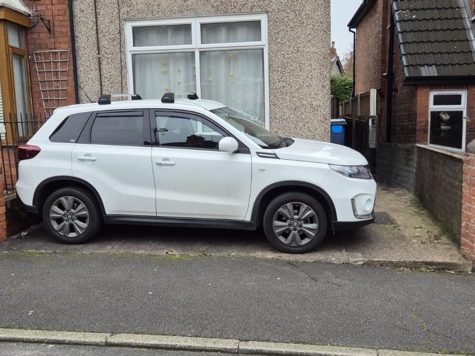

                                                      Not easy to get the car onto the space and restricts the size of car we can get and any access, hence why I only also charge at night.
                                                      I only put the Vitara on there for the survey and don’t normally park it on there. Which I have charged  only once  so far since I got it and still have 66% as we all had colds and not been out much.
