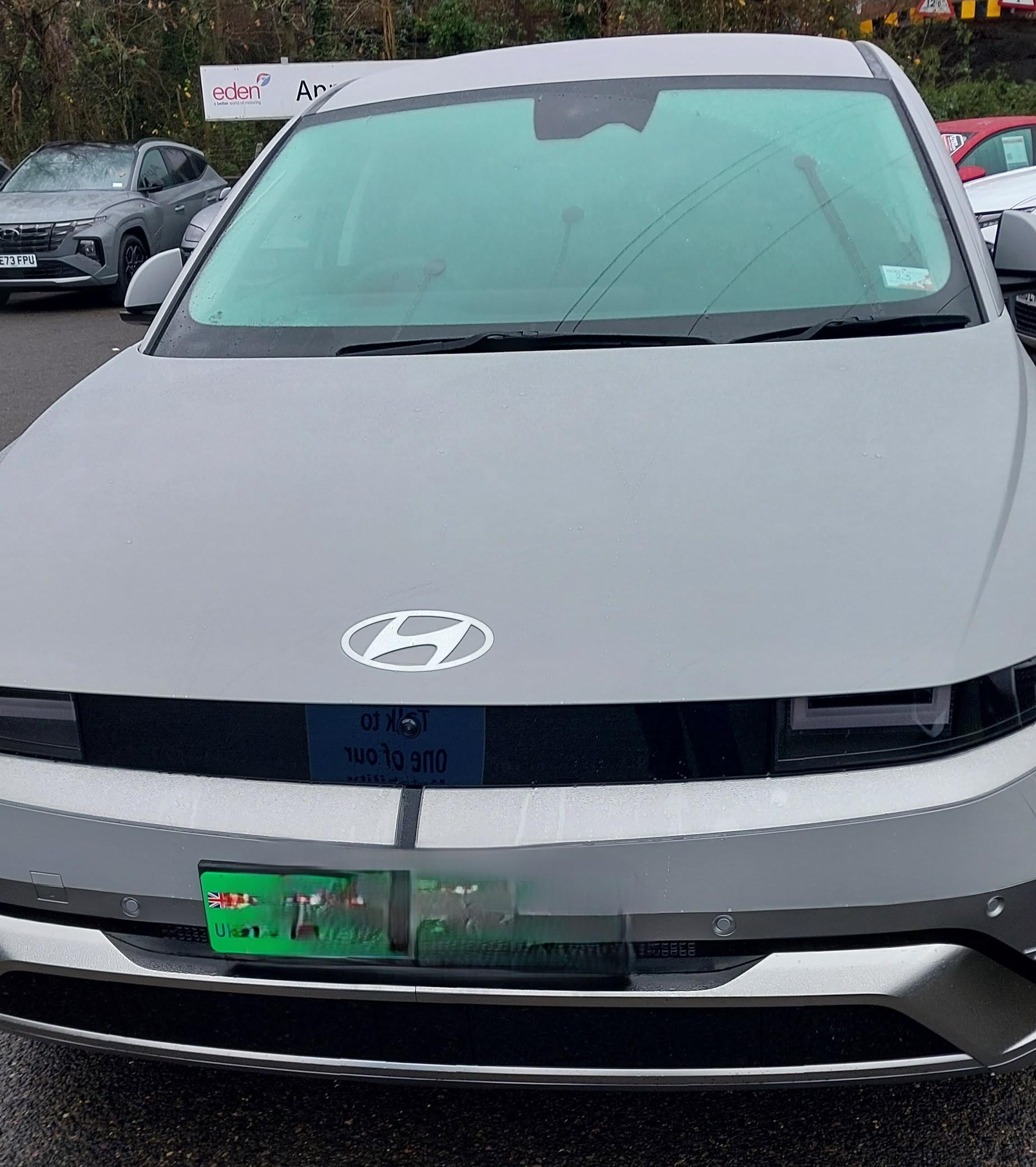

      Got my MY25 RWD car with tech pack over the weekend and absolutely love everything about it.
