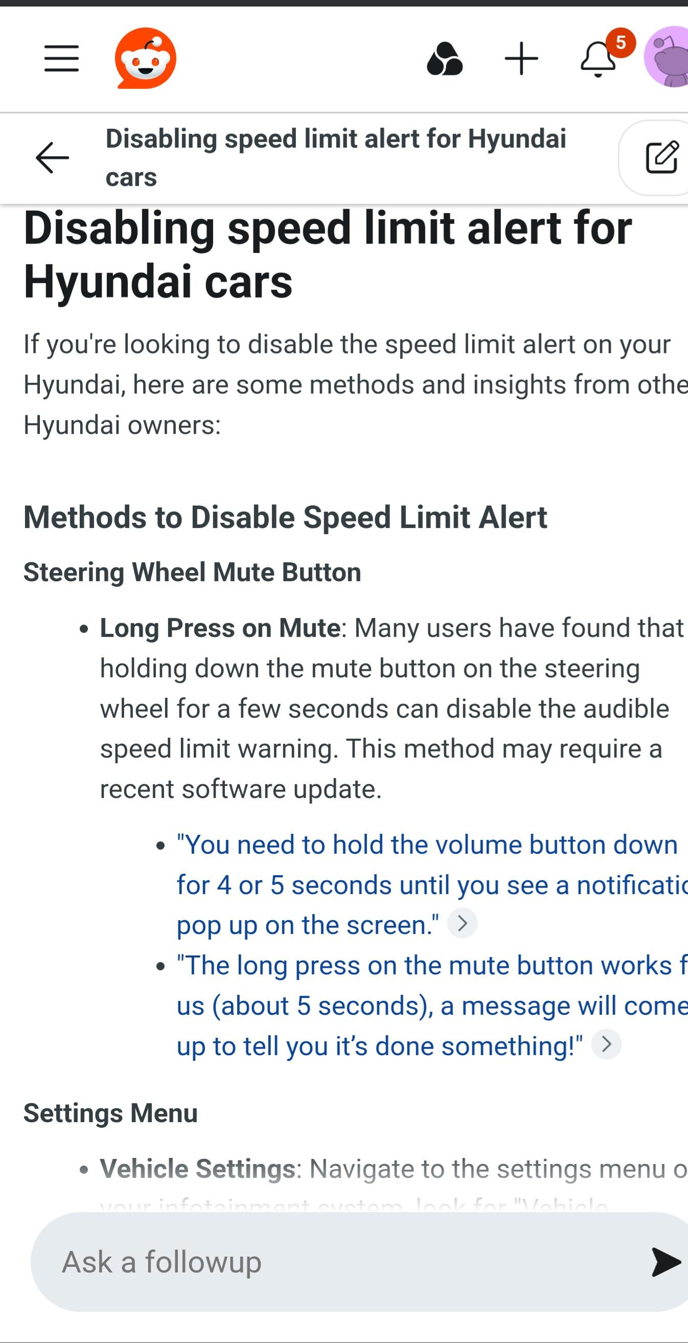

                      Is this link any use, the sales lady is going to show me how to turn off the systems, when we pick up the 6, on the test drive, there seemed to be very few bongs, and it was inkeeping with the speed limit, which incidently, the bloke on the speed awareness course said you should turn it on.
                      https://www.reddit.com/answers/d377ee2c-7021-43c9-86d0-ce8a6dee7571/?q=Disabling%20speed%20limit%20alert%20for%20Hyundai%20cars&source=PDP

                            Is this link any use, the sales lady is going to show me how to turn off the systems, when we pick up the 6, on the test drive, there seemed to be very few bongs, and it was inkeeping with the speed limit, which incidently, the bloke on the speed awareness course said you should turn it on. https://www.reddit.com/answers/d377ee2c-7021-43c9-86d0-ce8a6dee7571/?q=Disabling%20speed%20limit%20alert%20for%20Hyundai%20cars&source=PDP
                            Thanks, but that’s how to turn it off, which I know. Annoyingly, you have to do it every single time that you start the car which on days when you’re jumping in and out of the car becomes a pain in the a@se. What I’m looking for is how to change the parameters, so that it only bings when you are a bit more than 1mph over the speed limit (which is the Hyundai default – and it bings four times 😡).

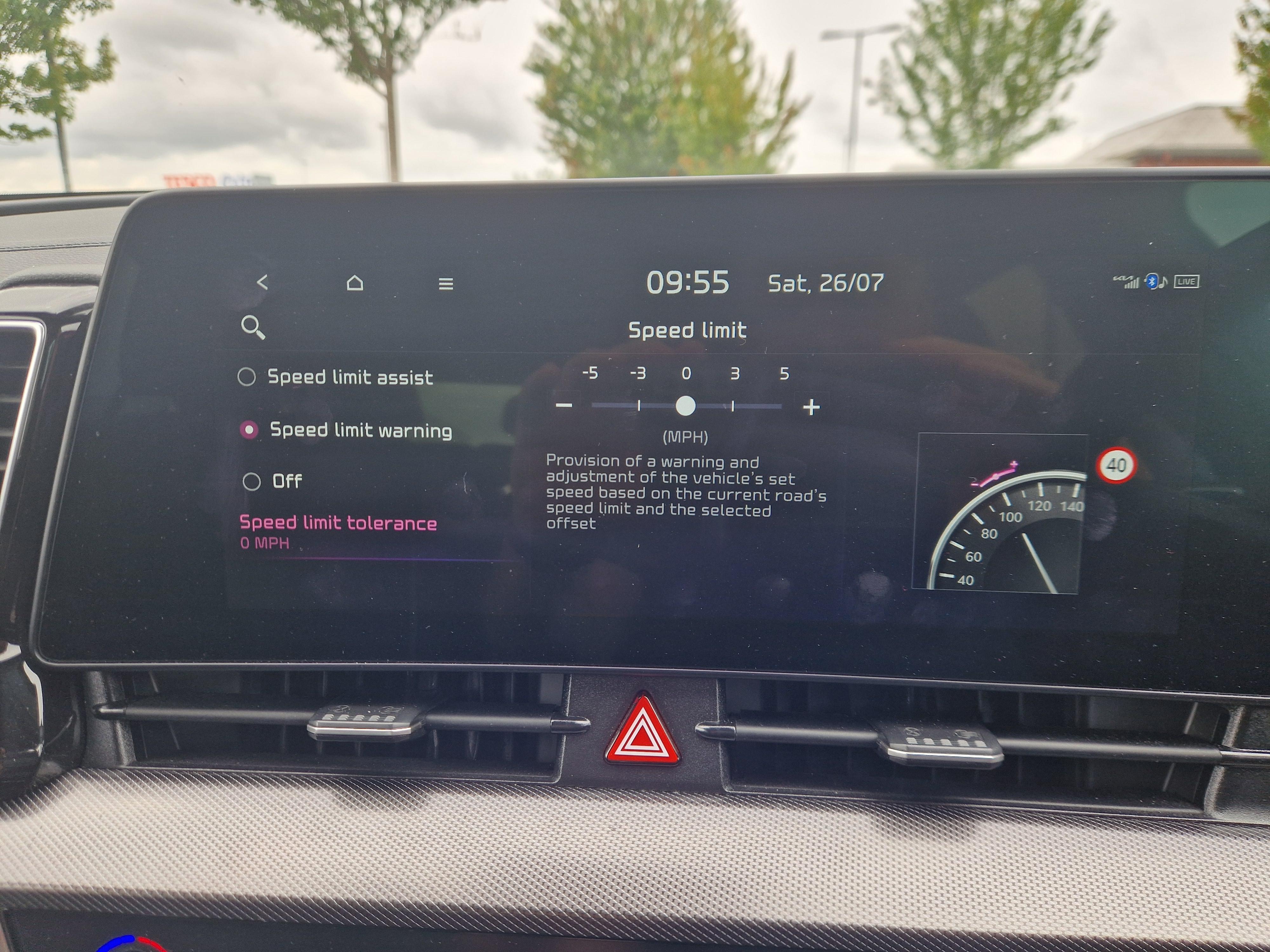

                                #310371
                                  @kezo The option to offset speed warnings (as opposed to Speed Limit Assist) by up to 10mph over the speed limit is exactly what I am craving, but I have looked several times and simply cannot find any option to do so. As per the screenshot, the sole option that I have is to turn warnings on or off. If there’s an option to do as you say then it’s so well hidden I cannot find it. If you could walk me through step by step how to do this I would be eternally grateful as I’m not sure that I can put up with two more years of this!

                                    This is what I have on our 72 sportage
                                    #310375

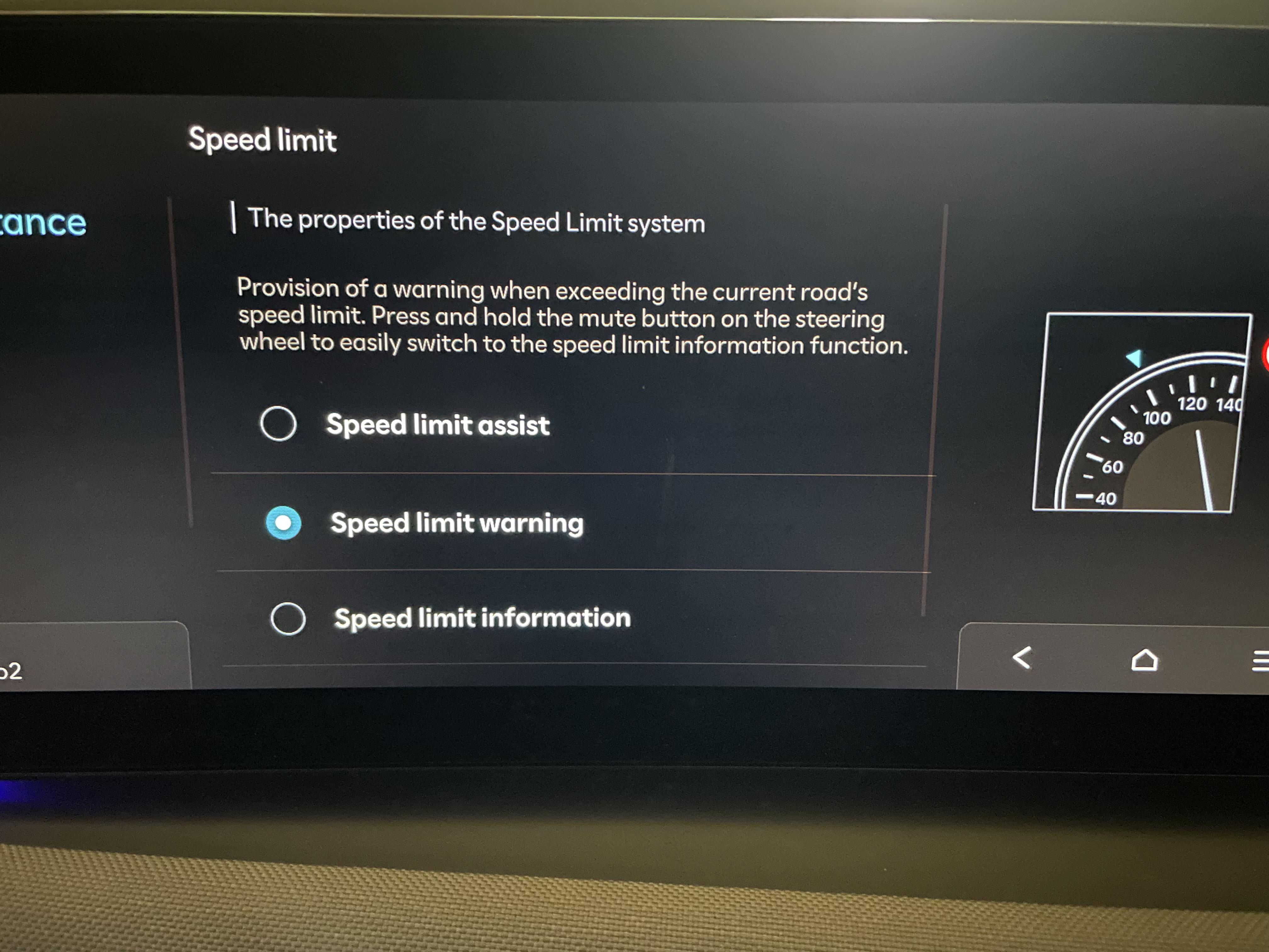

                                      + @Glos-Guy
                                      Yes thats it and upto 10mph were avail on some of the Hyundai group cars and could be left off if required.
                                      This, though is the old system and was aptly named manual speed limit assist. The new Sportage, like the Tucson along with the groups EV’s will have ccNC and intelligent speed limit assist!

                                          Yes and the best think to do, whils’t driving off from your driveway is to press the volume mute button for 3-4 seconds.
                                          Voice command introduced with the March 2025 update (campaign FR_CRM_UPGRADE (99211Q0C) & CLUSTER (940C3Q0A) can also be used and will be applied a yourupcoming service.
