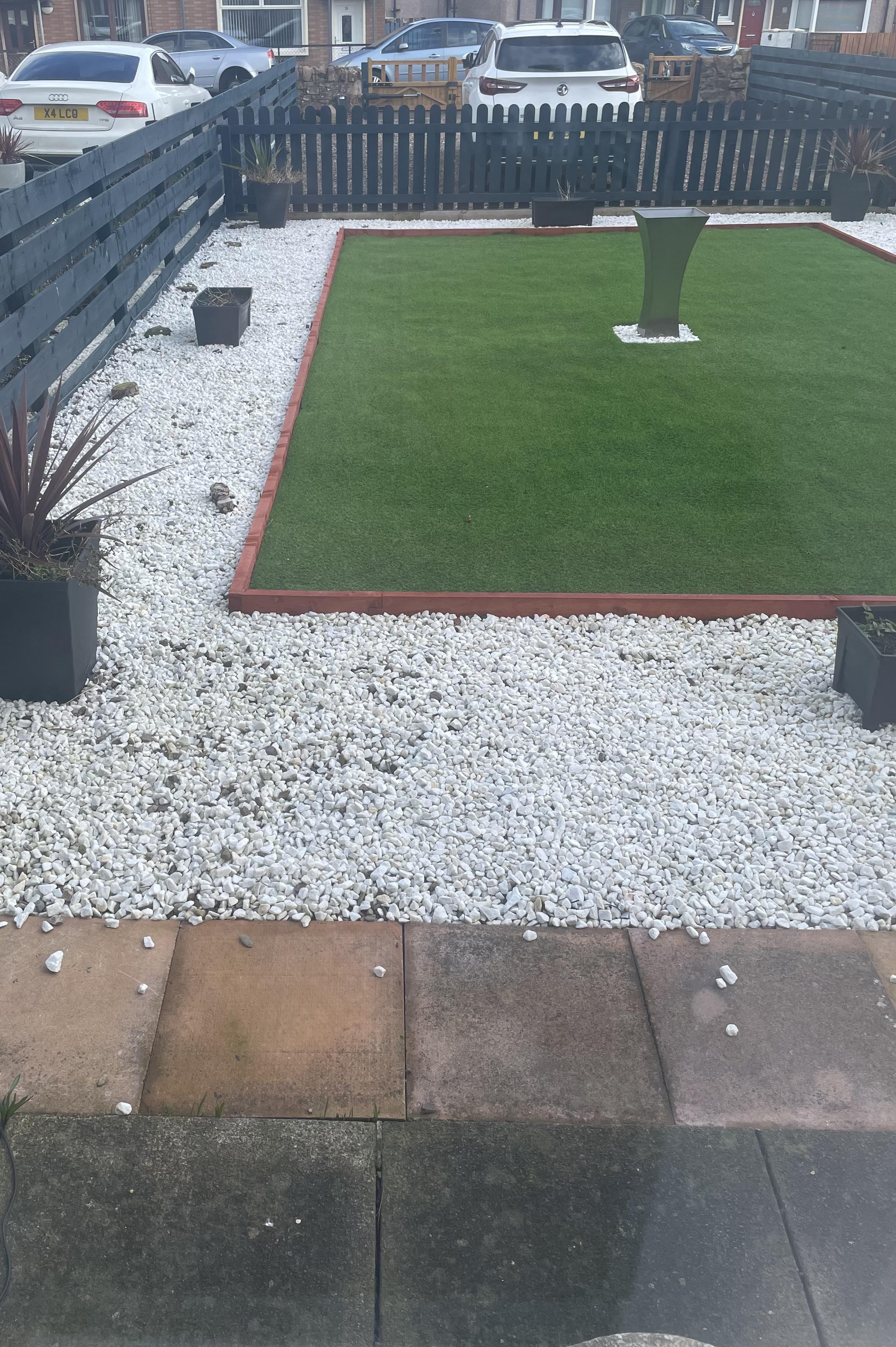

                A photo showing the front of your house and driveway would be good but, based on what you have said, this is how I would approach installation in your situation –
                Opt for the Ohme E-pod
                -Ohme E-Pod (non thethered) charger fixed to the front of the house near meter box or closest part of house in relation to driveway. (standard install)
                -The option of a 7.2kW Type 2 to Type 2 charging cable ranging in sizes from 10m to 20m in length
                If you went for a 15m (£275) or a 20m (£349) charging cable you would have 2 options (1) plug each end inwhen wanting to charge or (2) fix it in such a maner where you have where you can coil the cable up on a holster near your driveway and the other end mounted in a type 2 plug holder ready to plug into the charger.
                Total cost ontop of a standard install  £275 – £349, less if 10 meter cable will be sufficient.
                You can in the future get an electrican to move the charger and install a post, if you really felt the need.

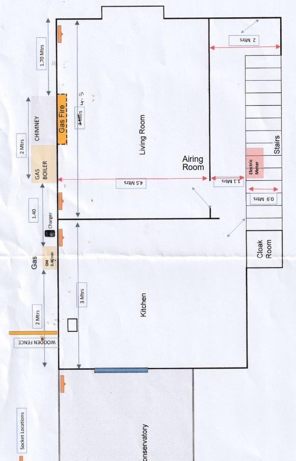

                #259754
                JJB

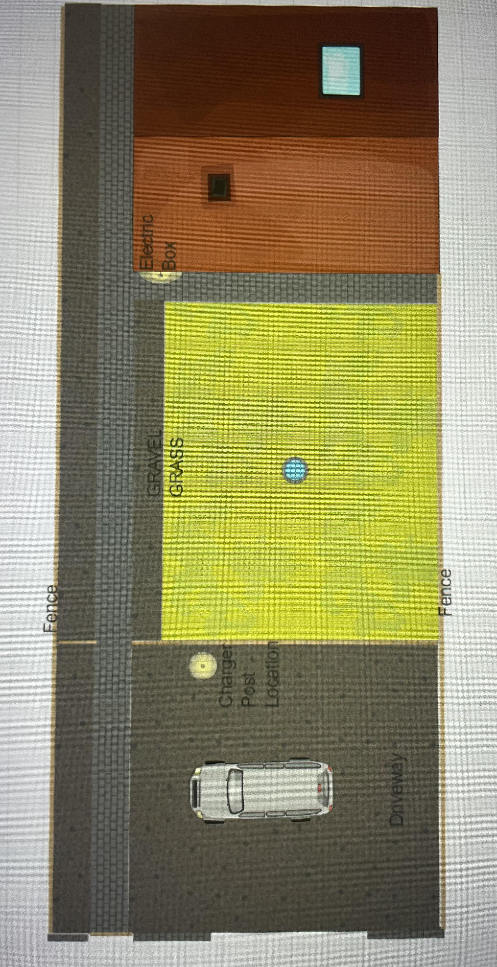

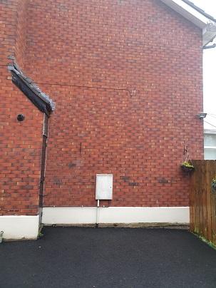

                  Thanks Kezo, genius idea.
                  I could have the Ohme E-Pod charger on the house to the extreme right of the electric box, about 2 feet in from the fence, then it’s out of the way and there is no vehicle or pedestrian traffic on that side of the garden, so no worries about people tripping over the cable etc.
                  Then as you suggest a 15m cable to the driveway and problem solved.
                  Why can’t the great minds at Motability and Ohme think like this, ah not enough profit.
                  Thanks again, I will contact Ohme tomorrow with this solution.
                  *The diagram/plan below shows where the charge point on the driveway was going to be placed, so the charge point location can now be ignored.
                  • This reply was modified 1 year, 7 months ago by JJB.

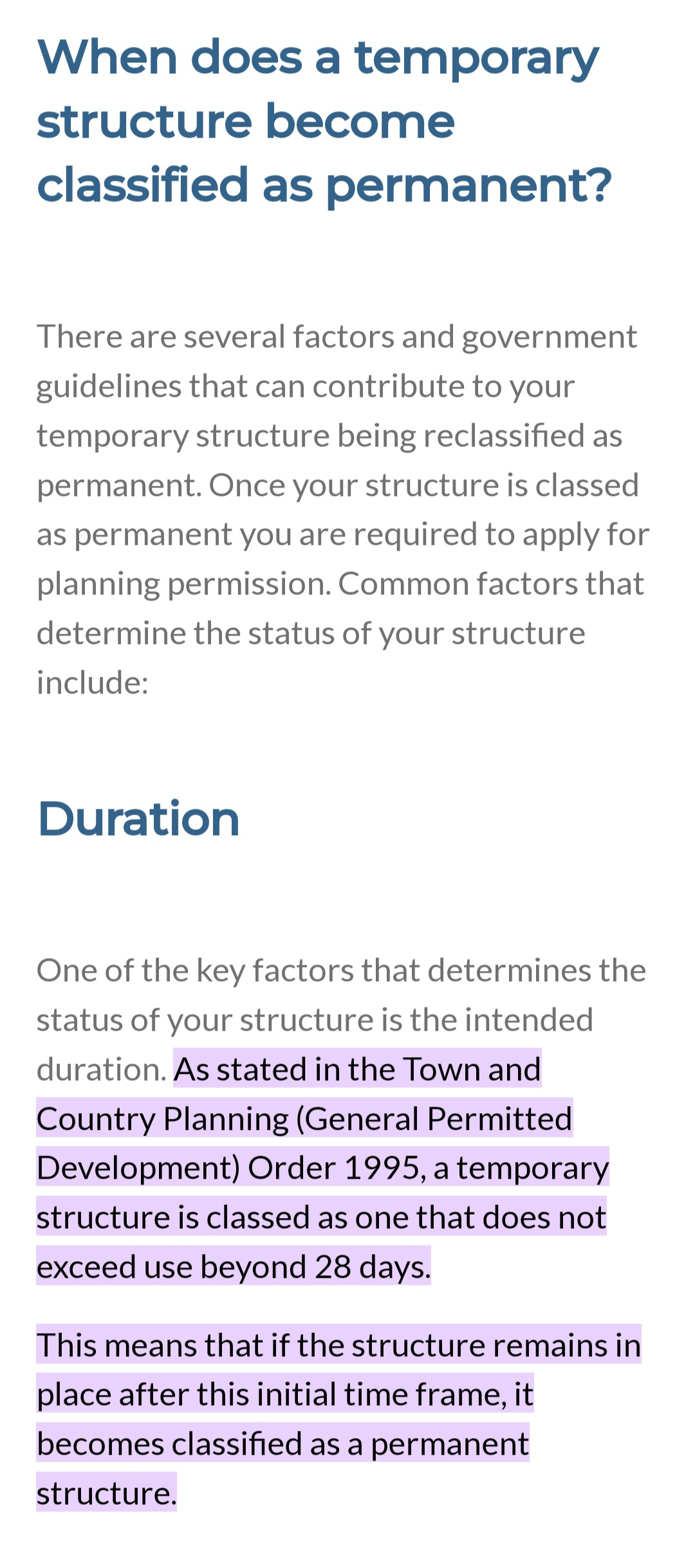

                    What are they stating is a permanent structural as uk define it as attached
                    So a fence (if structurally sound). Or a concrete fence post or Shed would be defined as permanent structure

                        Thanks Kezo, genius idea. I could have the Ohme E-Pod charger on the house to the extreme right of the electric box, about 2 feet in from the fence, then it’s out of the way and there is no vehicle or pedestrian traffic on that side of the garden, so no worries about people tripping over the cable etc. Then as you suggest a 15m cable to the driveway and problem solved. Why can’t the great minds at Motability and Ohme think like this, ah not enough profit. Thanks again, I will contact Ohme tomorrow with this solution.
                        The E-Pod would also look neater stuated on the far corner of the house and near the meter box, would make it a standard install where Motability/Ohme are concerned.

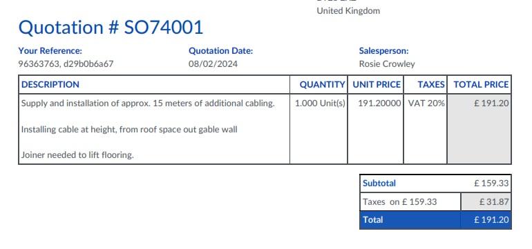

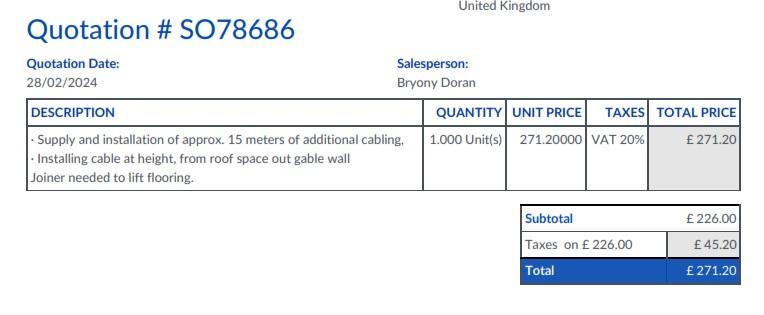

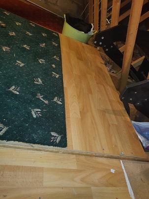

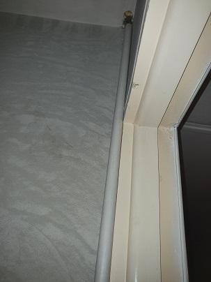

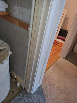

                            Hi. I’m new to this. I just ordered an Ariya. Ohme asked me to do a survey so I did. I quickly got an invoice for £191.20. It only stated on it an additional 15m cable. £12.88 a mtr. I told them I  require 18m after I checked my figures. 1st 15m should be free. In the end I simply asked them to send a qualified person for a survey. SSE sent an engineer he said 18m to 20m that was nearly 2 weeks ago. I got an invoice for £271.20 for additional 15mtrs today. Now its £18.06m . I’ve asked them for a detailed invoice and the SSE engineers report. Mobility Operations called me today “Jordan” he spoken to Ohme and they will now look for alternative installer. I raised the issue over the price changes in 15m of cable. they are looking into this as so many complaints are coming in as EV takes off.  Clearly this is wrong and I agree they are taking advantage of a monopoly situation as the only company allowed to do Mobility.  I informed the Nissan dealer of the issues and that i might cancel. I now know that I will not be charged for this. Mobility and Nissan are not happy.
                            This is the path the cable will follow.
                            Meter box under stairs. Shows Solar panel route on right to roof spaceCloak Room next to meter boxThe cable comes under floor from stairs on right to airing room. Continues up to roof space in airing roomcomes into roof space to right of steps under 1 board which i will remove prior to instalation. it then goes to the right hand side of floor where no boards are comes through the wall down to the gas meter box on left hand sideDetailed Floor planQuote 2
                            This is the response I received from Motability, he confirmed also that they are looking into the problems as there has been a lot of complaints. Hopefully they will make a move to change to other suppliers so Ohme have to operate in a competitive market for the work.
                            LETTER BACK FROM MOTABILITY
                            Thanks for your time this morning, I appreciate you explaining the situation in more detail over the phone.
                            As discussed, I have approached Ohme already who have confirmed they will seek a breakdown of the cost of the quote and will also request an alternative installer to assess and quote for the job. I have gone back to them again following our call, to ask them to explain why you have received a greater amount on your 2nd quote and for an explanation on why it is showing as an additional 15m of cabling being charged when it is suggested that only a max of 5m would be required.
                            As soon as I have any further information, I will update you straight away. However, if you have an any further queries you can contact me by email or by direct line on 0300 020 5010. As an FYI I am unable to answer calls on Monday, Tuesday and Wednesday but should have some capacity to respond to emails.
                            Best regards,
                            Jordan Dunning
                            Senior Customer Solutions Account Manager
                            Motability Operations
                            This is an update on my Complaint to Ohme,
                            Dear Trevor,
                            I hope this email finds you well.
                            Firstly, I would like to thank your patience while our Installation team evaluated your complaint regarding the work required at your property further with our installer. The Installation team has spoken with the engineer that carried out the site survey and have described the following route for your installation:
                            The cable is required to be run under the stairs, up through under the floor, run along the hot press cupboard, up to the ceiling into the roof space. The cable will then travel the length of the roof space, out to the gable wall, along the wall, and fit at your desired location.
                            Although you mentioned that there should only be 3-5m of additional cabling, the installer has confirmed that the route requires a total cable run of 30m, which is 15m more than the standard allowance. It also requires the assistance of a joiner to lift the floors where the cable is required to be run underneath and to ensure the floors are put back as they were met.
                            The breakdown of the quote is as follows:
                            – Supply and installation of up to 15m additional cabling: £316.80 incVAT
                            – Additional labour (joiner needed to lift flooring): £224.40 incVAT
                            The total comes to £541.20 incVAT. After deducting the Motability £350 contribution, the remaining amount is £191.20.
                            The installer has indicated that they believe this is the most feasible route to complete the installation to standard. If you do not agree with the route described, please let us know. We value your feedback and are committed to ensuring your satisfaction.
                            Thank you once again for your understanding and cooperation. We look forward to hearing from you soon.
                            Regards,
                            Keith
                            Complaints Team
                            complaints@ohme-ev.com  |  +44 20 3375 1586 | www.ohme-ev.com
                            My Reply.
                            If I did not need an extra 10m of that cable you want to charge me for or any floor boards lifting I would not need any additional costs as the Motability £350 Contribution would cover it all.
                            I can guarantee you do not need a joiner to lift my floor, its a simple task anyway and I put down the flooring in 2 rooms upstairs recently and repaired the creaking floor boards myself.  If a joiner did need to lift the boards from the top of the stairs to the hot press its less than 2m. Don’t you think paying a joiner £224.40 as a bit over the top.  In addition to get to the hot press it can be done from beneath the Hot press as solar people did it. This was explained to the engineer as well. He even asked if I minded if they used the same point in the cloak room.
                            £316.80 for up to 15m of Additional cabling. I take it the “Up To” can be seen as a safety margin that can be anywhere from 1m to 15 metres extra, Is that correct?
                            If only an extra 5m is required I could have expected a refund of 10m of cable and the labour you charged up front from customers. or do you just keep it all anyway?
                            I would like you to explain in more details and I am formally asking for a full copy of the SSE Engineers report.
                            Trevor

                                      What are they stating is a permanent structural as uk define it as attached So a fence (if structurally sound). Or a concrete fence post or Shed would be defined as permanent structure
                                      Your posts are refering to planning permission.

                                          Yes most probably
                                          I can’t see an issue with mounting a charger on a concrete fence post if its structurally sound or running a cable along a gravel board if also structurally sound

                                                Yes most probably I can’t see an issue with mounting a charger on a concrete fence post if its structurally sound or running a cable along a gravel board if also structurally sound I still await my quote from ohme, it’s only been worth the installation partner for 2 weeks with no contact Chased Ohme and still nothing
                                                I was refering more so to a wooden fence.
                                                However fixing a charger to even a conrete fence post may have stability issues due to the size of the charger and be open to water/moisture ingress and would require a fixing plate preferably not wood.
                                                Why can’t the charger be fitted to the house?
