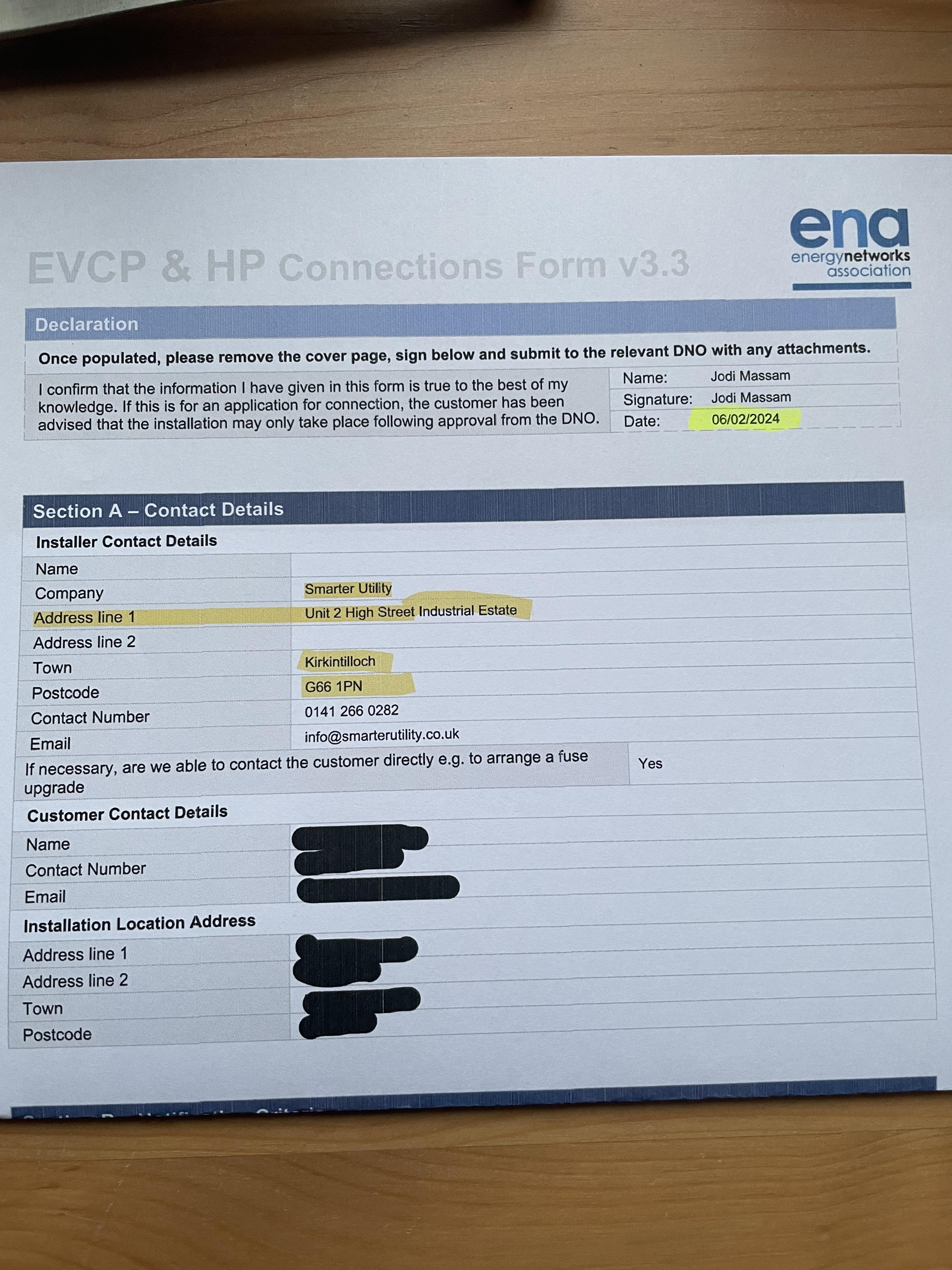

                              #259660
                                Unit 2 High Street Industrial Estate High Street, Kirkintilloch, Glasgow, Scotland, G66 1PN The last one is interesting, as it was dissolved on 31 Jan 2023, but they used this company and this address on the EVCP & HP Connections Form v3.3, which is dated 06/02/2024. A year after the company was dissolved and still using that address etc. Something not quite right here?
                                Unit 2 at High Street Industrial Estate, located in Kirkintilloch, Glasgow, G66 1PN, is associated with the Contact Energy Technical Academy
                                https://energytechnicalacademy.co.uk/contact-us

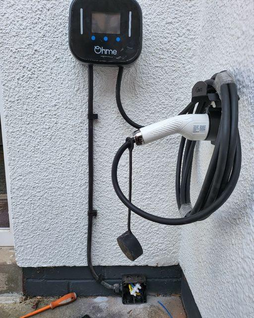

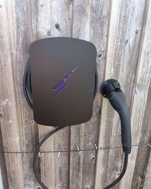

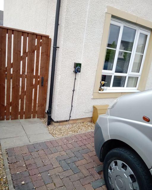

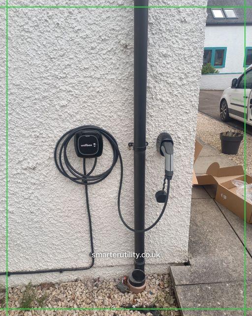

                                  A sample of their work proudly presented on FB!
                                  Can anyone spot what is wrong?
                                  #259664
                                    Doubt they have a spirit level between them!
                                    #259666
                                    JJB
                                      Oh dear, the plot thickens, fictitious address on the DNO application, what next?
                                      Not an expert, but grateful if you could share what is wrong with the installations.

                                        Oh dear, the plot thickens, fictitious address on the DNO application, what next? Not an expert, but grateful if you could share what is wrong with the installations.
                                        Any standing water from rain/snow will eventualy seep in and fill the the junction box with water – would have been better to lift a few inches off the ground.
                                        Timber fencing is not considered to be suitable for supporting cables or electrical items in general, such as a charger, for reasons –
                                        wood preservatives may attack the cable sheath
                                        timber fencing is unlikely to be sufficiently rigid
                                        the life of timber fencing is likely to be less than that of the cable
                                        damage sustained to the fence due to high winds (may present a risk of electric shock)

                                            A sample of their work proudly presented on FB! Can anyone spot what is wrong?
                                            It’s also telling that they would put work that was substandard on their Facebook page believing it to be a good example of their work.
