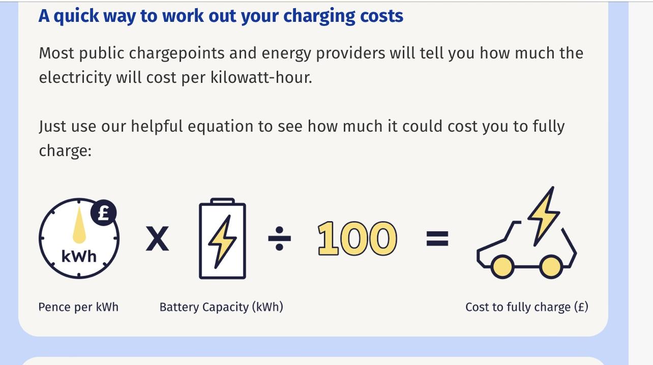

      In order to try to increase my knowledge of all things EV related (which is not difficult) I have subscribed to the weekly emails that Motability provide over 6 weeks. This weeks email is about charging costs. I was surprised to read that average cost per mile if you rely on fast chargers or rapid chargers is more than running a petrol car but, that aside, I am confused by the equation that they show to calculate how much it would cost to charge an EV. They state that to work out how much it will cost to charge your car you perform the following calculation;
      My home electricity costs 26.85 pence per kWh. If I take the BMW iX1 as an example, it has a 150kwh battery. So that is 26.85p x 150 (=£40.27) divided by 100 equals 40.27 pence to fully charge the vehicle. Clearly nonsense, so what am I doing wrong?
    • #252106
      Debs
        In order to try to increase my knowledge of all things EV related (which is not difficult) I have subscribed to the weekly emails that Motability provide over 6 weeks. This weeks email is about charging costs. I was surprised to read that average cost per mile if you rely on fast chargers or rapid chargers is more than running a petrol car but, that aside, I am confused by the equation that they show to calculate how much it would cost to charge an EV. They state that to work out how much it will cost to charge your car you perform the following calculation; My home electricity costs 26.85 pence per kWh. If I take the BMW iX1 as an example, it has a 150kwh battery. So that is 26.85p x 150 (=£40.27) divided by 100 equals 40.27 pence to fully charge the vehicle. Clearly nonsense, so what am I doing wrong?
        The battery usable capacity is 64.7 kWh. 150 is the power of the iX1 30
        26.85  x. 64.7 divide by 100 = £17.37
        Hope that helps
        #252107
          Thanks @Debs I realise now that I was being ultra thick and when working out 26.85p x 150 I was converting that into pounds before dividing by 100, whereas the divide by 100 does that – so I was doing it twice. It’s been a long day ?
          Plus I thought that the 65 kWh was the charging speed, not the battery capacity. As I say, I’m starting from a very low base ?

            @Glos Guy – two things:
            1). The battery capacity of the iX1 is not 150kwh. That is the maximum rate at which it can charge on a rapid charger. The capacity is probably around 60kwh for the 20e (I’d have to look it up to give an accurate figure). The i4 e35 I have on order has a battery capacity of 71kwh (actually 67kw usable), so using your electricity price the cost for a full charge would be £17.99.
            2). However, the idea of a home charger is to take advantage of the smart charging rates available, the best of which is currently Intelligent Octopus Go, which provides a guaranteed 6 hours at 7.5p per kwh, plus random cheap hours during the day based on when Octopus decide the grid is underused or that there is a surplus of power. These charging schedules are sent to you via an app.
            In addition, whenever the car is plugged in and charging on the smart tariff, the whole house (washing machine, dishwasher etc) is also charged at 7.5p per kw.
            So the i4 would cost just over £5 for a full charge and around 265 real world summer miles. Not bad huh? ?. Deduct 20% or more for cold winter days.

              I see Motability’s assumption is based on easy maths 0-100%, when in reality you mostly  charge from 20-80% and thus need to know what 60% of a given battery size, to work out the cost to charge.
              The iC1 has a 64.7kW useable battery – 60% of 64.7 = 38.82kW’s needed to charge from 20-80%
              Price per kWh x (60 x 64.7 / 100) /100
