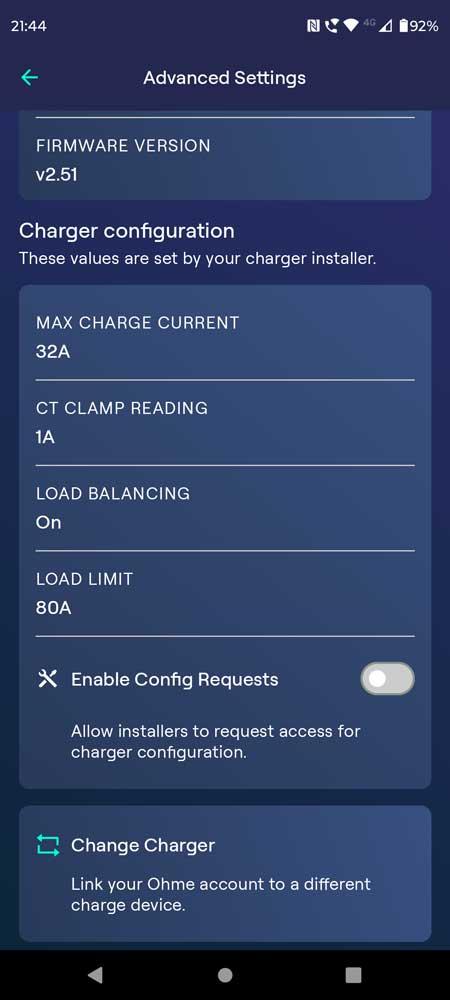

    @Jojoe Open the Ohme App, tap on the little charger icon in the top right corner, go into advanced settings and you should see the screen below. Check and see what your Load Limit is set to, it should be 80A. If not you can ring Ohme and ask them to reset it.
    the 80a you have is relative to your home. Mine is 100a as thats what my main fuse is rated at. It can differ per house.
