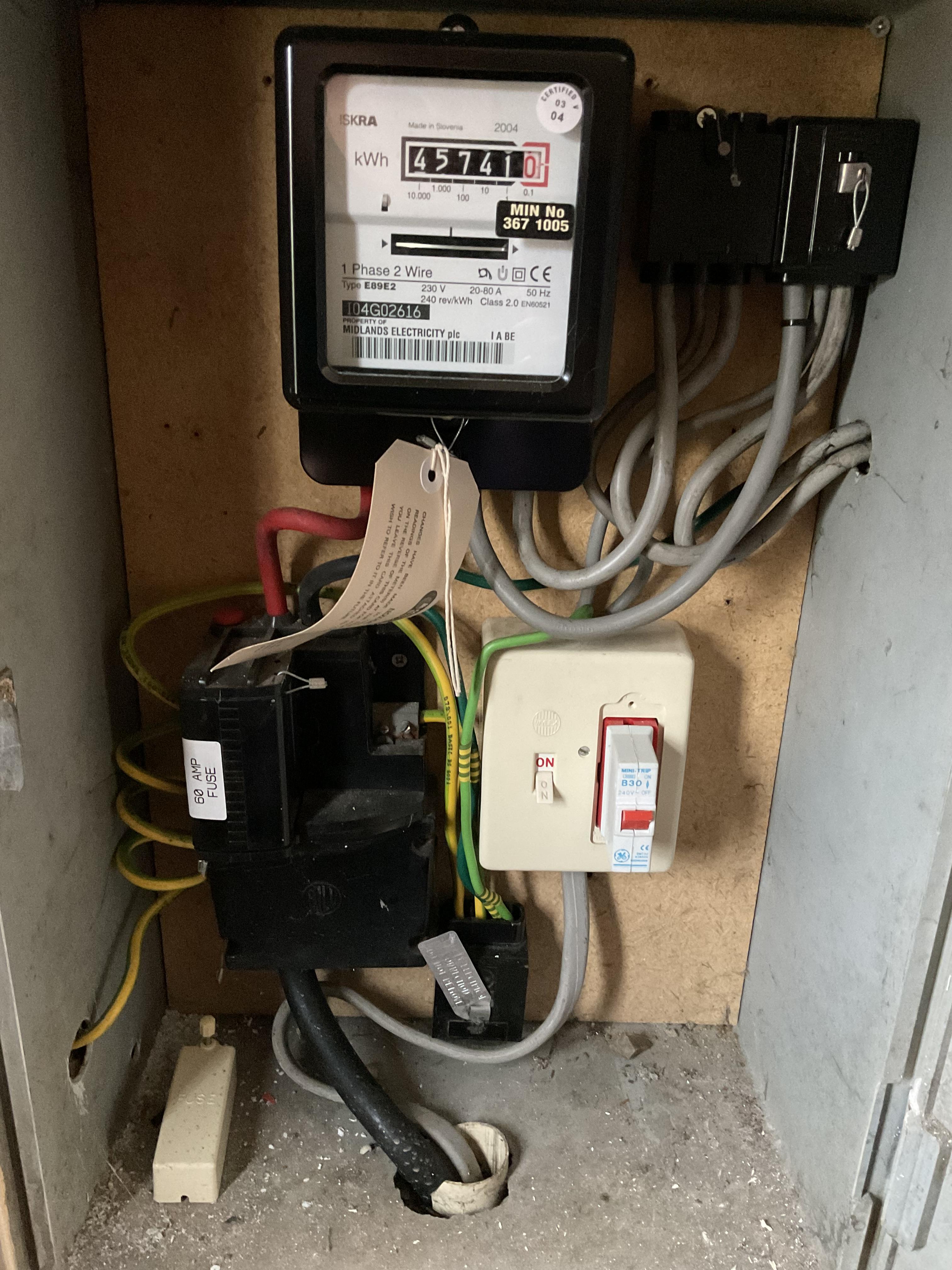

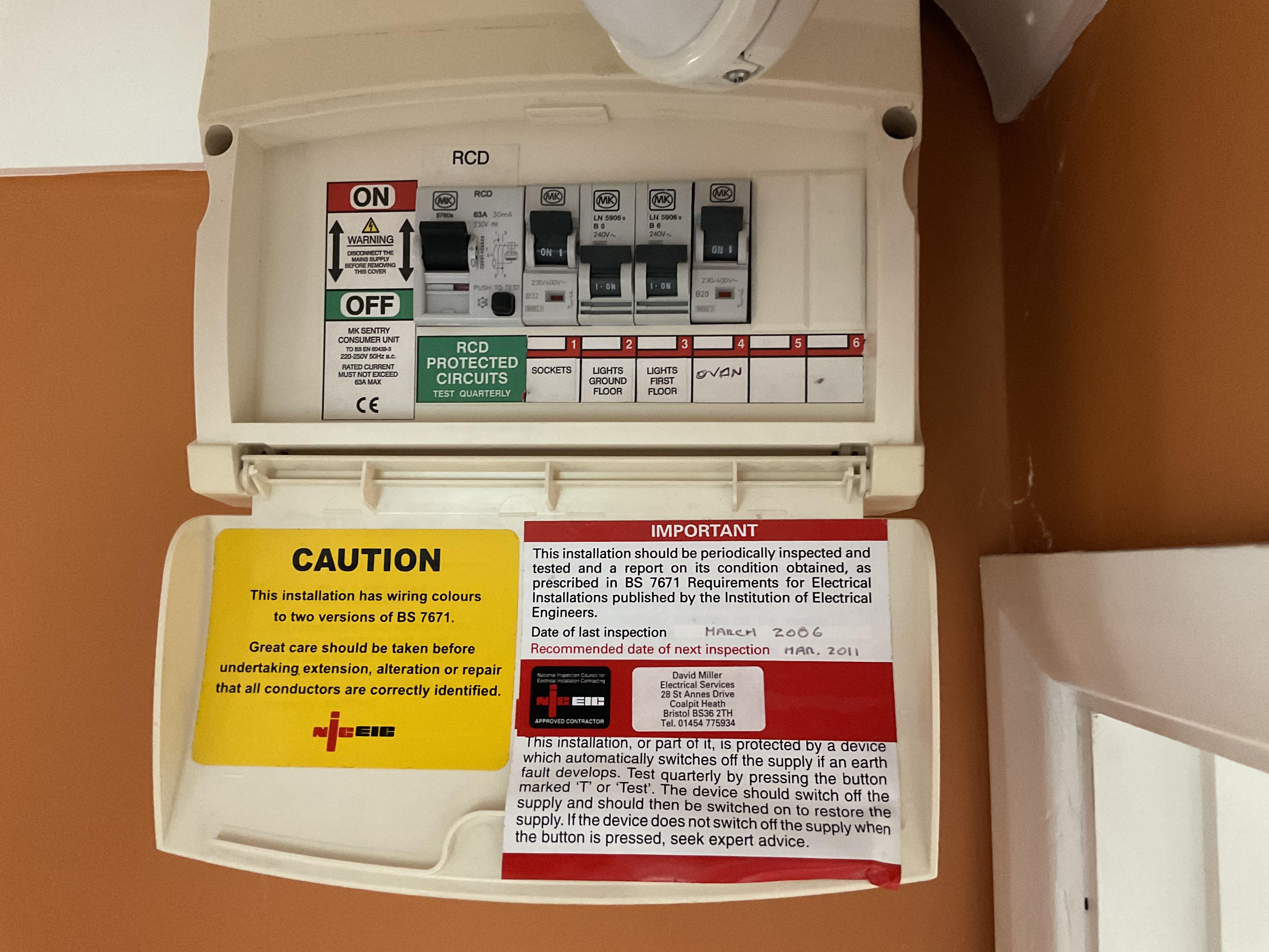

    Cheers @kezo. First photo shows the electric meter. This just has a thin door in front of it as it used to be on the outside of the house, but is now inside a brick built porch. It is recessed within 18 inch thick stone, which the original part of the house is built of. The second photo is the main consumer unit, which is mounted under the ceiling in the ground floor hallway (next to the porch). The final photo is the second consumer box which is in the extension. It runs off the main one, but there is no visible wiring between the two. This last box is the one that would be closest to the point where I’d want the charger (either in the garage – around 30ft away from it or, if that’s not viable, on the outside wall behind it. Hope that all makes sense?
