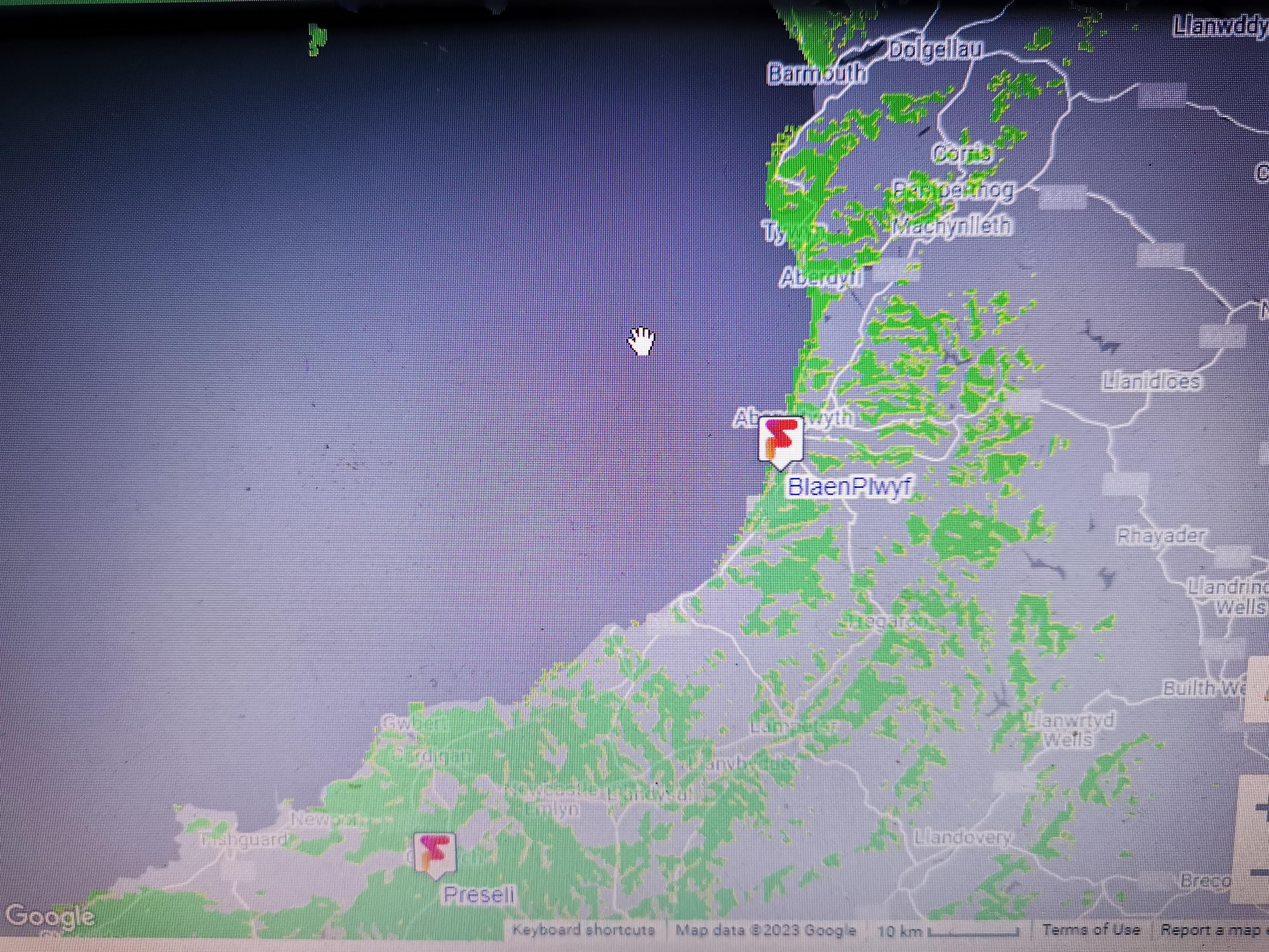

    Presli Transmitter coverage:
    BBC programs use Mux PSB1 (BBCA) Horizontal / C43+ (650.2mhz) (2000w)
    ITV/ch4/ch5 programs use Mux PSB2 (DS+4) Horizontal /  C46+ (674.2mhz) (2000w)
    HD programs use Mux PSB3 (BBCB) Horizontal / c40+ (626.2mhz) (2000w) ?
    Blaenplwyf Transmitter coverage:
    BBC programs Mux PSB1 (BBCA) Horizontal / c27 (522mhz) (40000w)
    ITV, c4, ch5 programs Mux PSB2 (DS+4) Horizontal /c24 (498mhz) (4000w)
    HD programs Mux PSB3 (BBCB) Horizntal / c21+ (474.2mhz) (40000w) ?
    I have not included programs on com4,5 and 6
