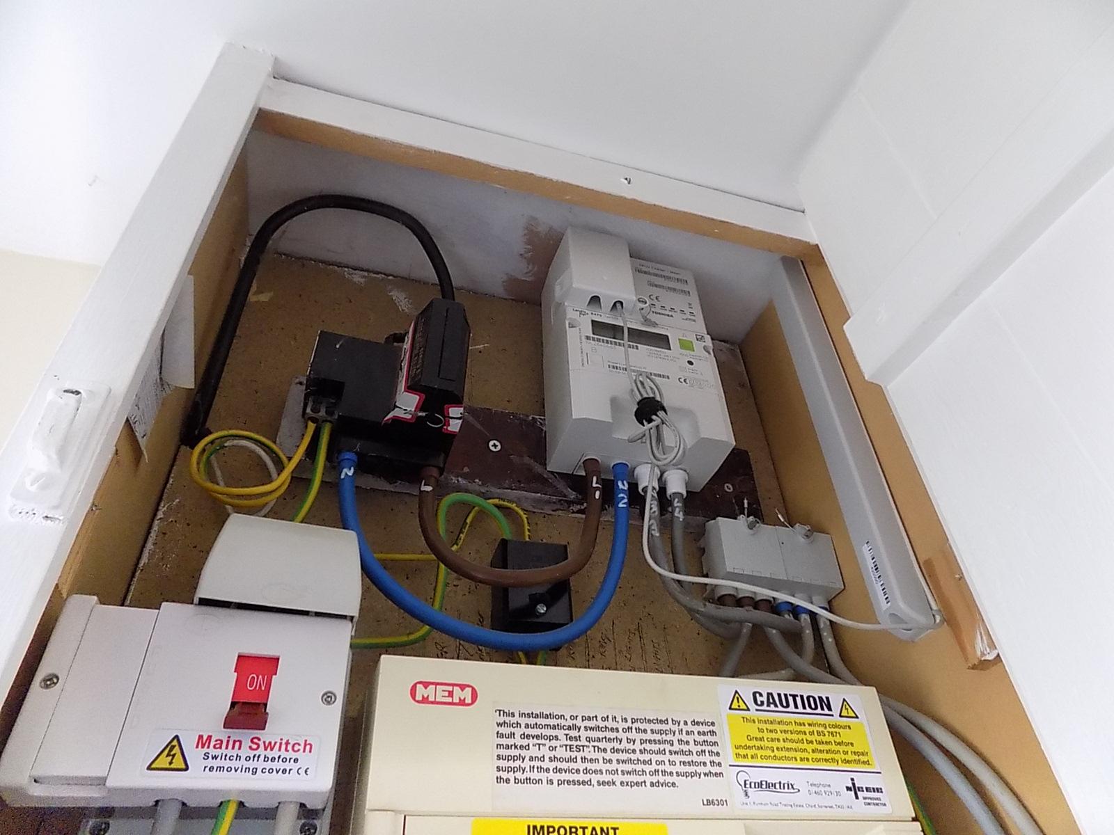

      Sorry if this is obvious. We are moving soon and this is the electric meter at the new home (pics from survey).
      Is this a looped supply as I suspect please?
      Looks like I may have my work cut out sorting a charger…..

          Avatar photoanarchy21
            Only one cable on main fuse. You could be the last on the loop.
            if I’m not mistaken.
            #284323
              No! unless you are the last on the loop, which you can find out by asking your ajoining neigbour if they have two “black” cables coming into the service head.
              If the property was built post 90’s its unlikely to be looped.
              Must admit, I was taken back by an upside down service head 😂

                It’s an older cottage and end of terrace (around 100 years old) hence my concern…….
                #284328
                  If you are looped of your neighbour its no great concern, as the DNO will cap the loop at your neighbours and and run a new supply from the street into your property, digging 1 or 2 holes in your drive/garden.
                  To put your mind at rest, you can ask your neigbour to check whether he has 1 or 2 service cables in the service head.

                                      Just had a call from National Grid who have been excellent.
                                      It is a single feed with no issues regards installing a charger.
                                      Thanks again everyone.
