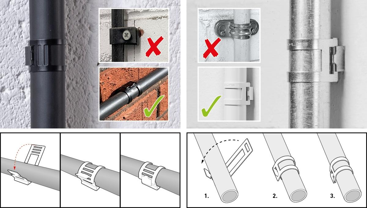

                                              The only thing I would have done different, is use SWA (armoued cable) clipped direct using Safe D clips (as below) rather than trunking but thats personally and ultimately down to the customer.

                                                #277247
                                                  Trunking was my word as it’s surface mounted, not chased into the wall. I’ll check what he’s proposing and show him your photo diagram. Cheers.
                                                  If an house is rendered, I normally suggest opting for D Line curved trunking coming down the wall, as its available in many colours and the Safe D clips,cliping the SWA below the render line. (I prefer SWA outside, as not only does it have more impact strength but also the current carrying capacity (Amps) is greater than T+E)
                                                  This short video shows the principle and will give you an idea what I’m rambling on about.
                                                  Other than you keeping me updated on the on going progess , I take it you have now made me redundant 😂
