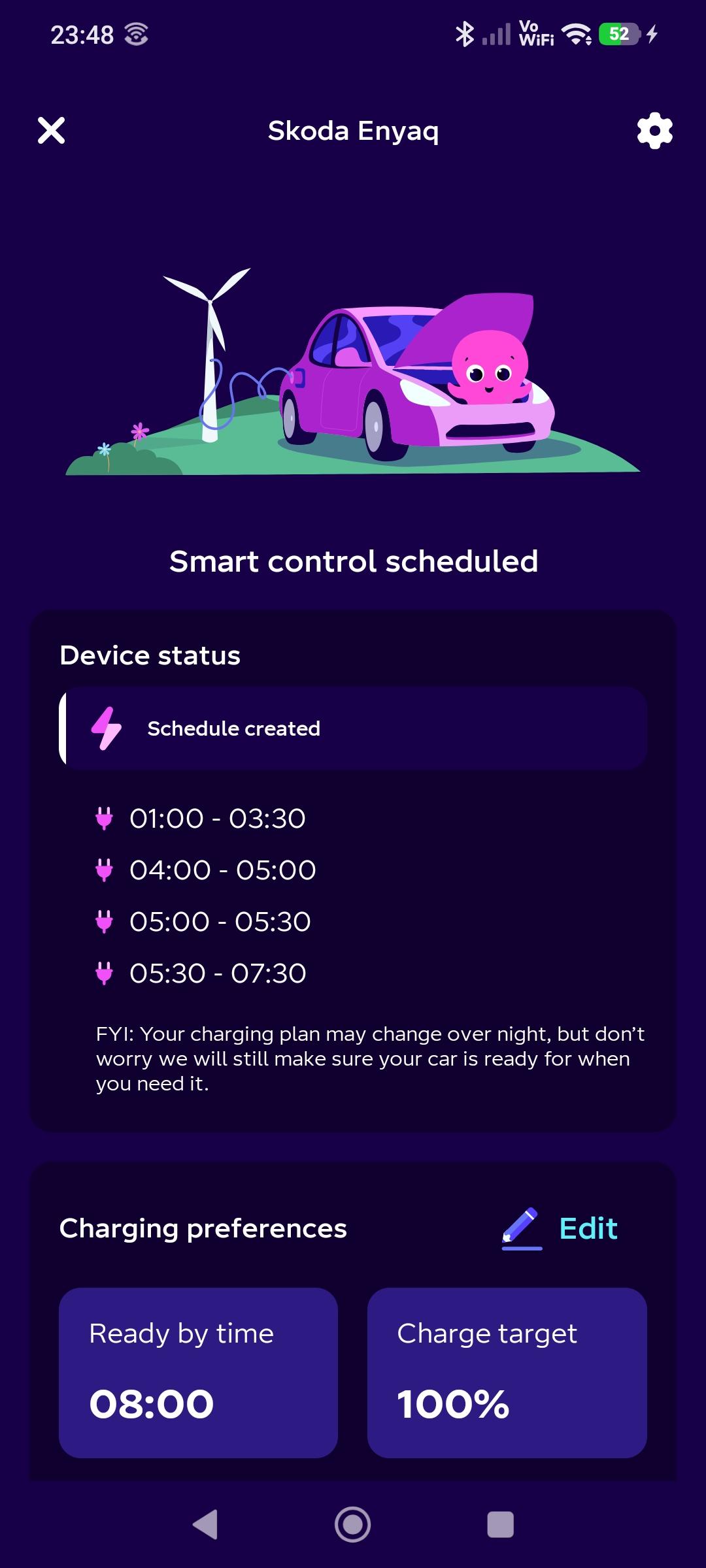

                    So far tonight it’s doing exactly what it did before.  Gave me the usual list of charging slots but so far it’s gone through 4 of them without doing any charging (see below).  If I turn on Max Charge it still shows “Max charging at 0.0kw” and switching back to Smart Charge just sets up a new list of charging slots.

                      Well it’s now 23:45 and it still hasn’t started charging 🙁
                      The last charge slot says 23:23 to 05:34 so I don’t hold out much hope of it charging tonight 🙁
                      Just checked the Octopus App and it also shows a schedule????  So am I not supposed to use the Ohme App then??  No idea to be honest!
                      I know when I changed to the new IOG Fixed 12m tariff it said to set up a device, but, my Ohme charger doesn’t show as an option, only the car.  It said to include the charger submit a request using a provided link to Octopus that would take 24hrs, did that well over a week ago and the charger still isn’t showing as an option to add to the devices.  This is getting very confusing to say the least.

                          It started charging at 00:00 so the Octopus App looks like it’s now controlling the charging.
                          It’s at 92% now, Ohme App was set to add 55% but says added 37% and stopped charging. Octopus App says charging to 100% by 8am but the cars not charging.

                              I’ve removed the car from Octopus devices and re-sent the request to Octopus to add my charger to the devices options.  Probably won’t work 🙁
                              #361955
                                Gave it a charge last night, car was at 71% so set the Ohme App to add 35%.
                                With it removed from the Octopus App Devices list it started on time using just the Ohme Smart Charge schedule.  This morning it said it had added 27% to get the car to 100%.  Car verified it was charged to 100% so it worked as it should.  Hopefully for now (until Octopus bring in the new Charge Cap) it should at least charge to 100%.
