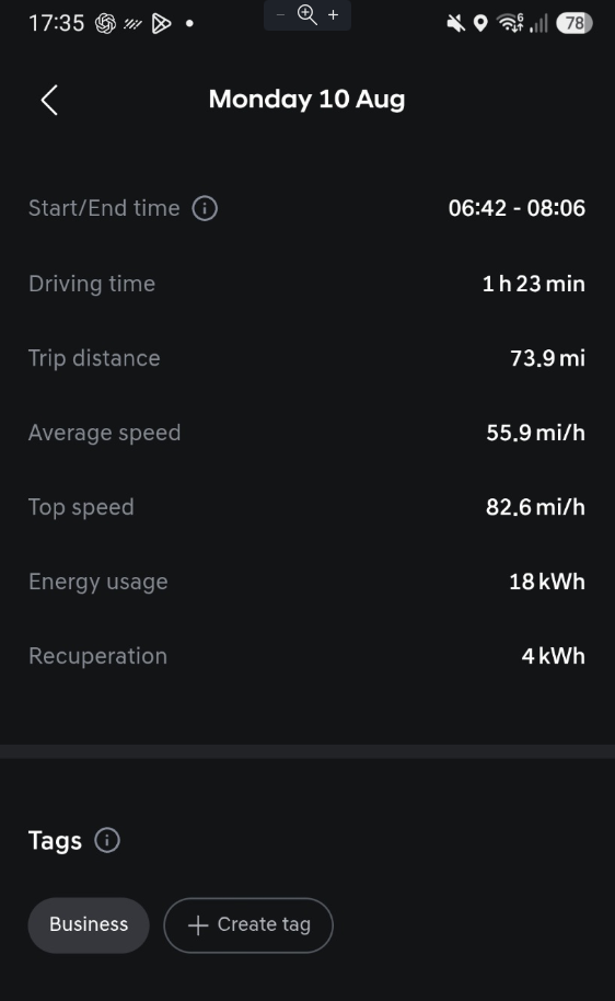

                                            It’s the impossible question for anyone to answer but yourself. I keep hearing about these EV drivers getting 300+ mile in motability cars and, well I’m not saying they’re lying, but I now believe that they spend most of the time toddling around cities/towns and are maybe frugal with heating etc as I never go over 3.1 mipkw which is around 220ish mostly motorway/city and 250ish mostly city/motorway.
                                            Top speed was a slightly too eager drive onto the motorway early in the morning. My bad, but didn’t want to fiddle now with the screenshot to hide that. Keep in mind that the average speed also includes the journey to the motorway, i didn’t drive 60mph on the motorway – generally i drive anywhere between 70-75mph depending on what other cars are doing.
                                            The recuperation is included in the energy usage, leading to 4.1 m/kwh (edit: meaning it was actually 22kwh total used, but 4kwh recuperated, making it 18kwh). Which is slightly below the average for our car. For longer motorway journeys, we generally end up at around 4.3 mi/kwh.
                                            That’s for summer. Haven’t had any long journeys yet in winter, but we got around 3.7 mi/kwh on a motorway stint (not long distance tho) in february.
                                            Around town we get upwards of 6-7 mi/kwh.
